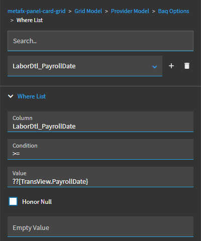

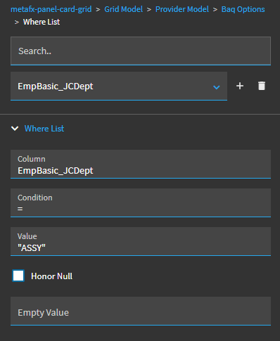

I’m trying to filter a grid via the BAQ options. I have two filters in the where list:
PayrollDate and JCDept.
I’ve set the payroll date > TransView.PayrollDate and the JCDept to = “ASSY”.
I want these filters to operate as an “AND” and have it honor both filters together, but it’s acting as an “OR” and giving me records that are either > than the date filter or equal to the department filter.

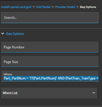

Try backing up to the Provider Model > BAQ Options and put your expression in there including “OR”.
I used “AND” in my expression below… but you can chain them together here. Below is my full expression, you can see I had several criteria on this one.
Part_PartNum = ‘??{Part.PartNum}’ AND (PartTran_TranType <> ‘ADJ-CST’ AND PartTran_TranType <> ‘PUR-SUB’ AND PartTran_TranType <> ‘Mfg-Ven’)

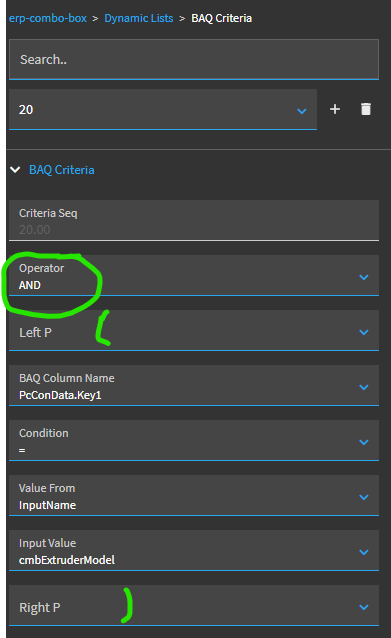

They need to build this out like the did in the Kinetic Product Configurator. In there, when creating a “where list” (BAQ Criteria) they actually give you the controls to select And/Or, and can also toggle parenthesis, as well:
But in this case they DON’T give you a field on the front end where you can just type in a full expression, which, to be honest is much easier than adding each criteria manually.
I have two grids with multiple filters. One of them works only with the where list and one works only with the BAQ Options where field like you showed above.
Actually, I thought the offending grid was doing an OR, but it was just malfunctioning with the second criteria and dumping everything. The single where field fixed that one.

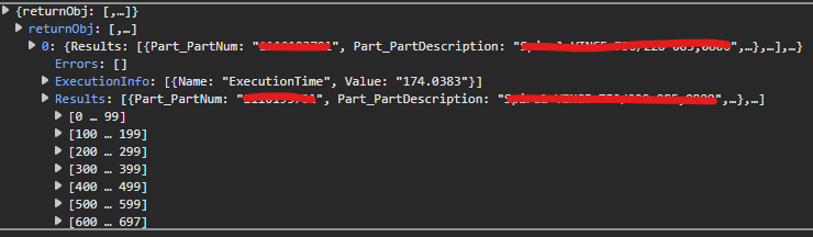

For some reason it does not work for more complex conditions like
Part_PartDescription LIKE '%220%85%''
It just skip the where totally and return all rows. It must be something on the client side because there is no where clause in the request payload at all.
BTW. It works fine if you send the request manually to Ice.BO.KineticErpSvc/ExecuteBaq (i.e. from postman) with the body like below
