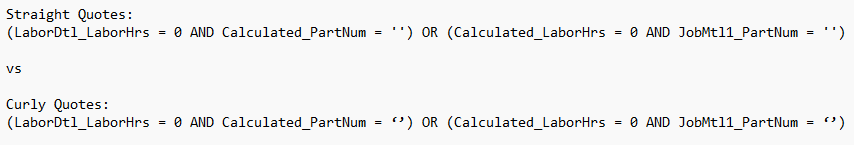

What you have as an expression looks decent… the only caveat would be to make sure you’re using straight quotes ‘’ vs curly quotes ‘’.
Hard to say whether these got changed when you typed, or copy/pasted in here.
Below is the straight-quote version if you want to paste it in and test.
(LaborDtl_LaborHrs = 0 AND Calculated_PartNum = '') OR (Calculated_LaborHrs = 0 AND JobMtl1_PartNum = '')
