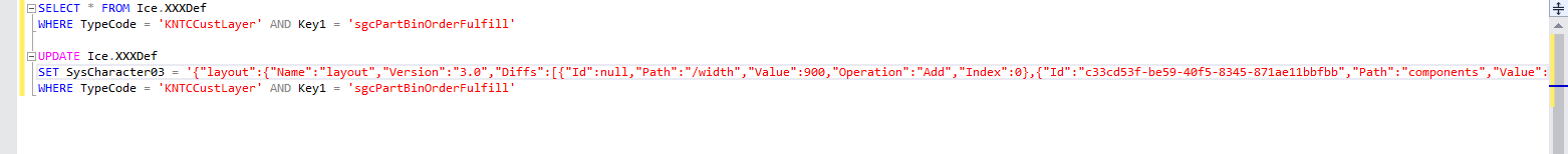

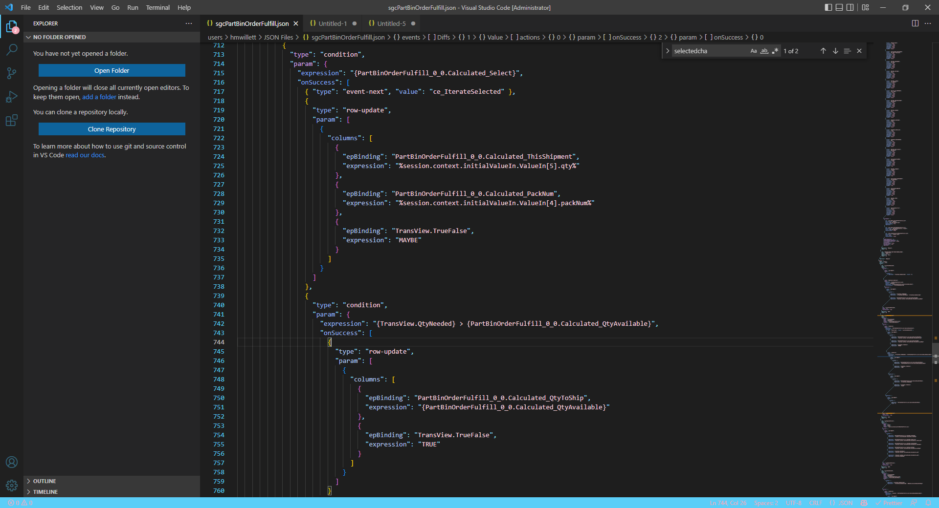

I don’t know how much you want to get into the weeds or if you even can (SaaS is SOL :stuck_out_tongue: ), but it turns out if you edit the JSON directly and load it back into the DB, it works a treat.
XXXDef.SysCharacter03 is the “WIP” App Studio code.
XXXDef.Content is the App Studio code once it’s published.
Disclaimer - THIS INVOLVES EDITING THE SQL DB DIRECTLY. USE AT YOUR OWN RISK. DON’T BE A MEATBALL AND DO THIS IN PRODUCTION (Use a solution for that).
I’m not responsible for the choices y’all make. :slight_smile:

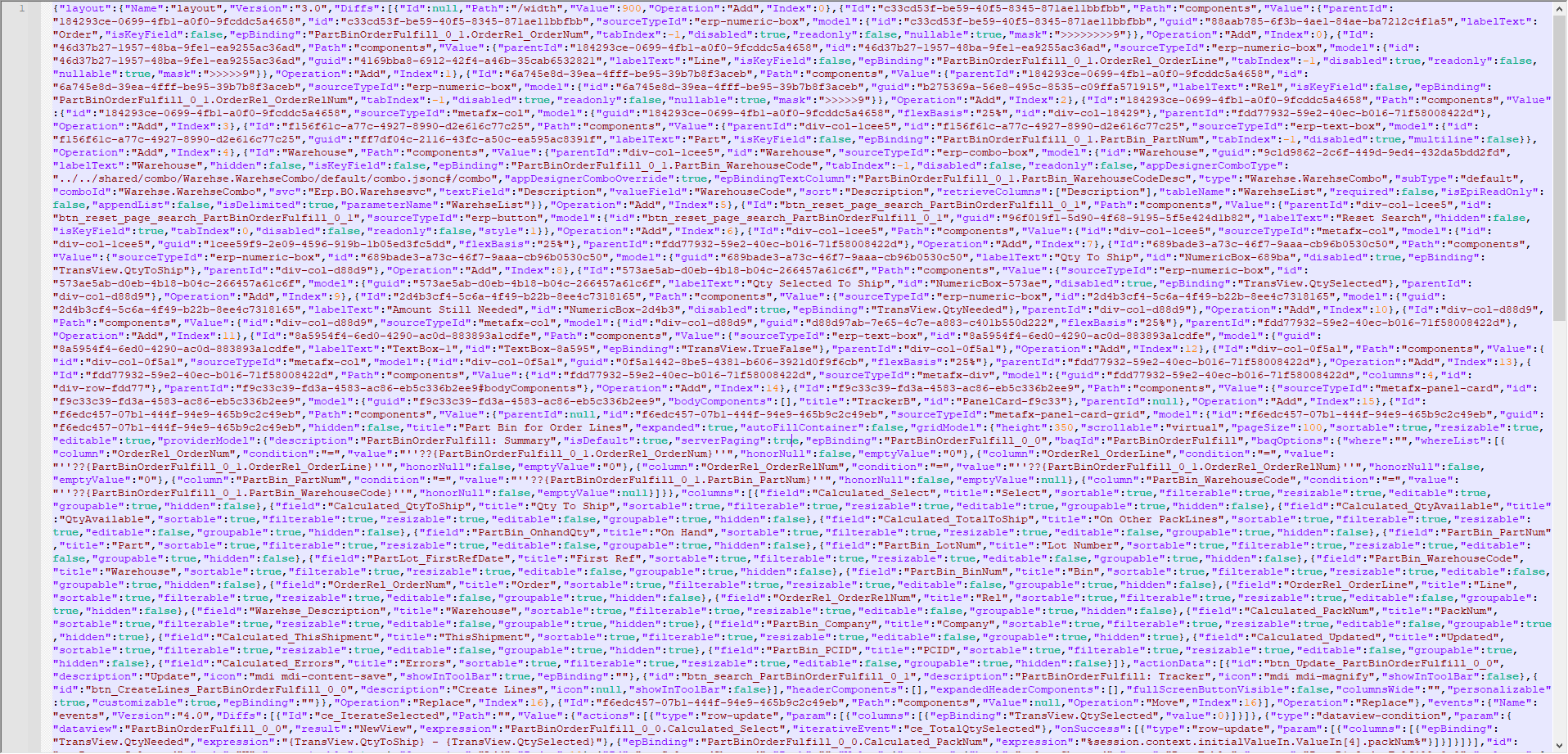

Make sure to compress the JSON before loading into SQL. SQL doesn’t seem to like the spaces and new lines. Also, make sure to replace any single quotes with two single quotes to escape them.
Compressed JSON
SQL Statement

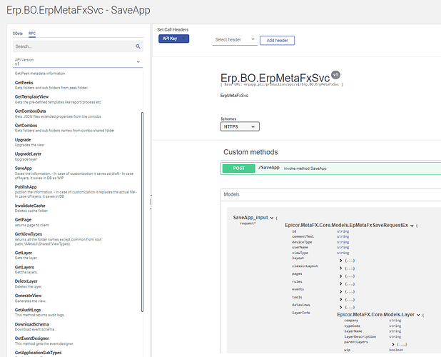

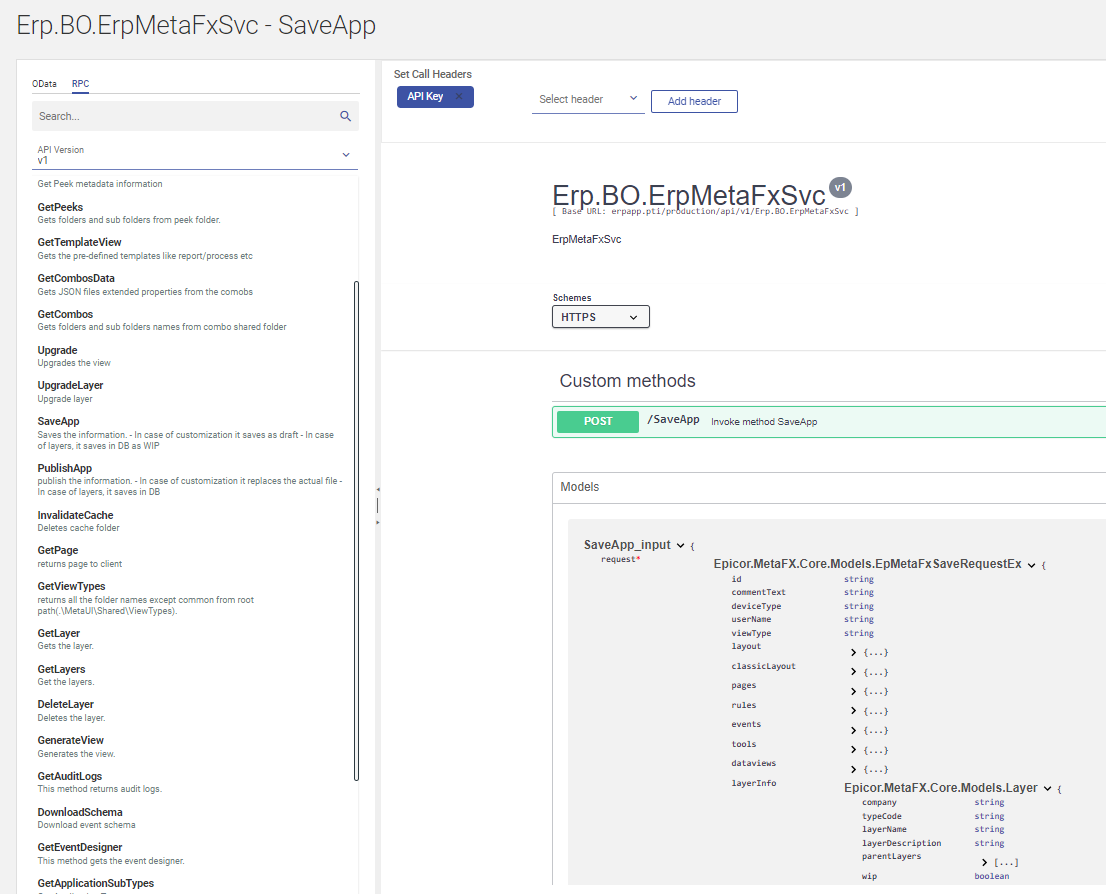

Well, no. You can use REST from PostMan or Swagger to update the database in the exact same way the UI does. It ain’t pretty, but it may be a path forward.
So, here’s the problem with that… It calls SaveApp just fine (no errors in the network call) it just doesn’t… save?
I was pushing it directly into the XXXDef.SysCharacter03 field in the DB.
I mean, it’s worth a shot. Get the JSON, alter it yourself, then try the REST call and see what happens.
