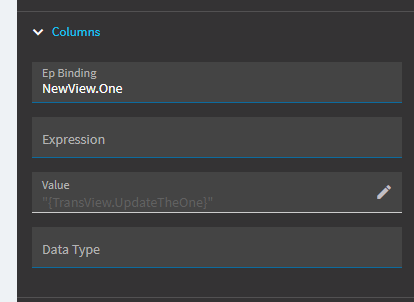

Otherwise, use the row-update widget. It will always update the “current row” AKA, the one your user has selected, but I would still advocate updating the grid without the textbox.
GridUpdate2
Thanks for the suggestions. I may end up editing from the grid. Depends on how may columns I end up with. I am having an issue with the row-update widget. What do your properties look like?
It works. Thanks!
