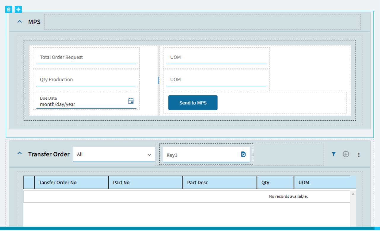

Hi, so I have a panel and Grid, This Grid can be selected. I want when my Row is selected it will update the field in the panel. I add some fields in the data view and use that field for the view in my panel. What should I add here so I can get the data selected from the grid? I want to sum all the quantities later.
I’m kinda lost here, what component should I create in the Application studio?

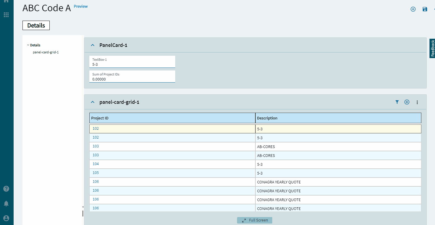

So, I got this working to what I think is your intention, but you’ll have to let me know.
Here’s the working iteration:
SumClicks

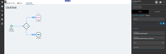

I created a new Event called “ClickTest” and made the trigger be of Type DataView, Hook Row Changed, and Target NewView (This will be the view bound to your grid).

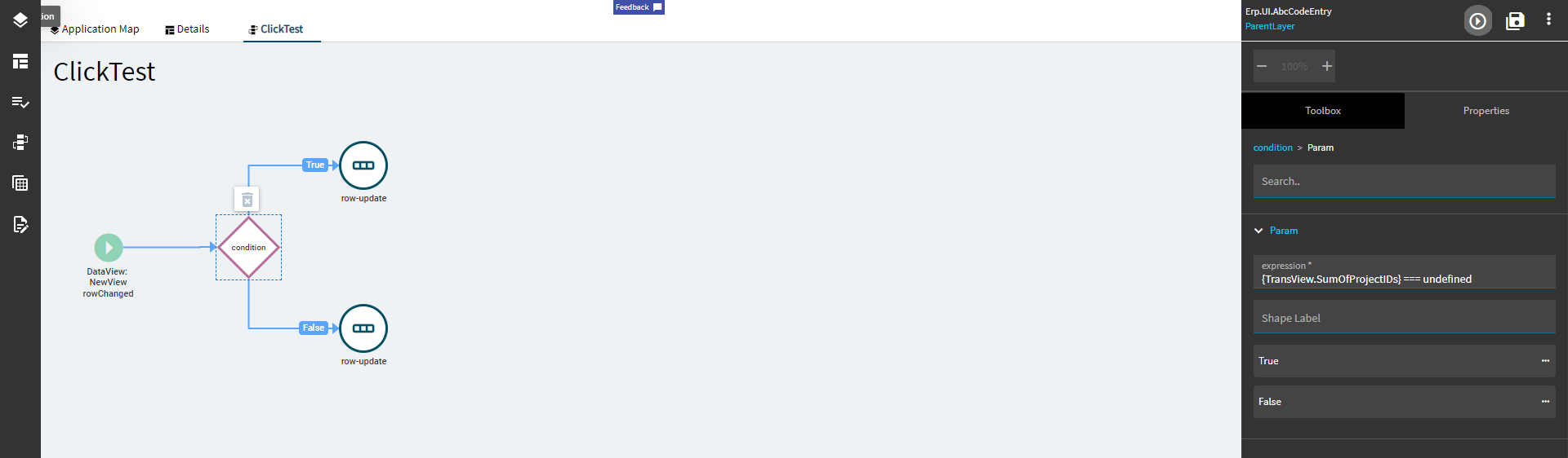

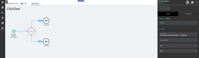

Within the event, I added a condition node to check if TransView.SumOfProjectIDs was created yet. Since TransView is a runtime view and that field is one I made up, then it will have to be initialized before you can do stuff.

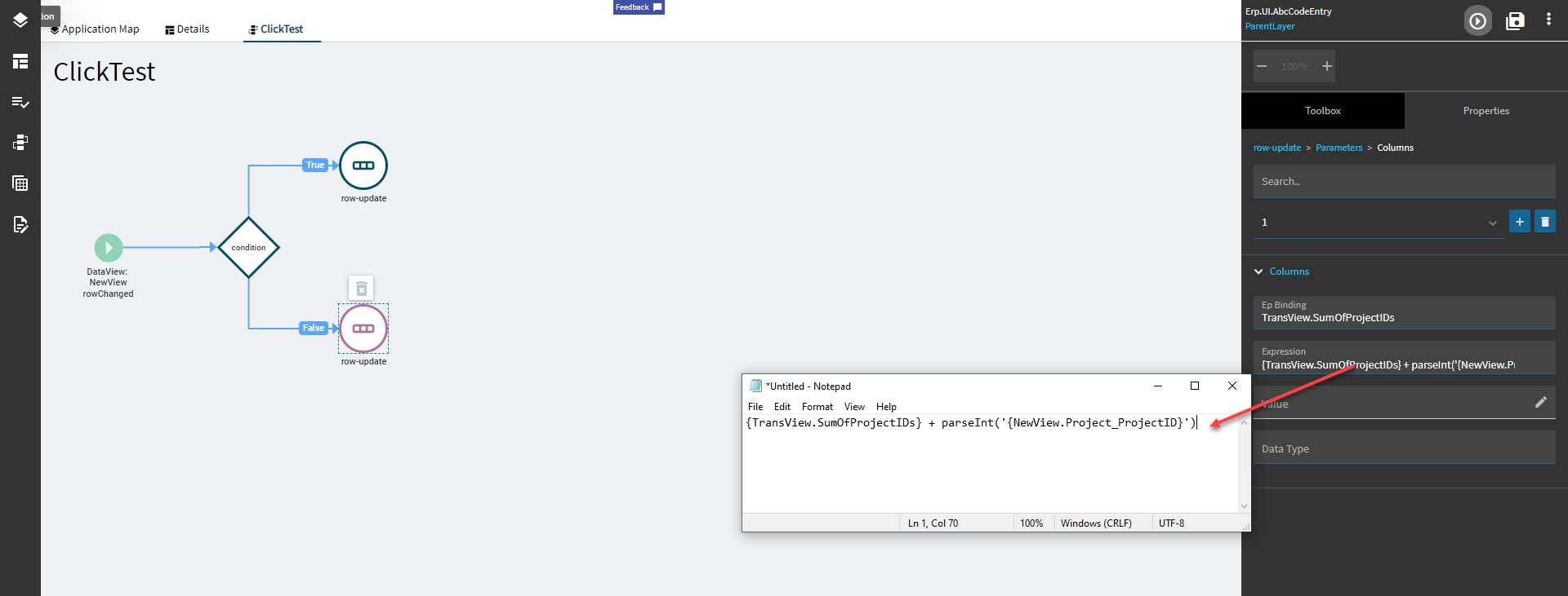

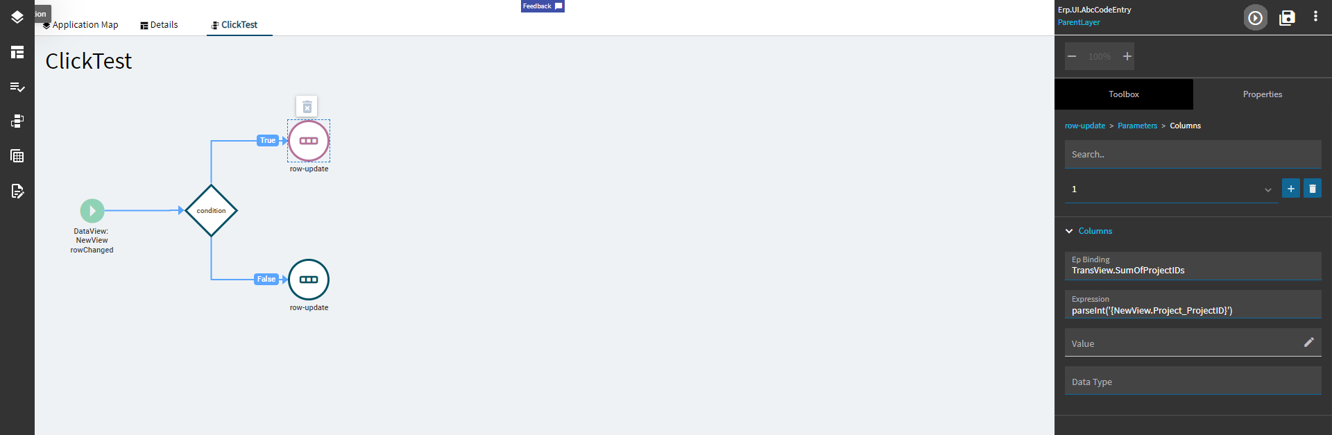

Off of the TRUE node, the condition is TransView.SumOfProjectIDs is equal to undefined which means it’s not created yet. In that case, I just set it to the ProjectID to create it. The ProjectID is a string, which is why I have the parseInt. I was just using what I had available on the screen already.

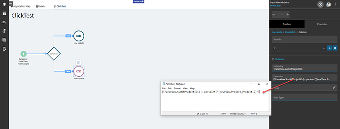

Finally, off of the FALSE node, I have it add the change to the value already in TransView.SumOfProjectIDs.

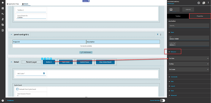

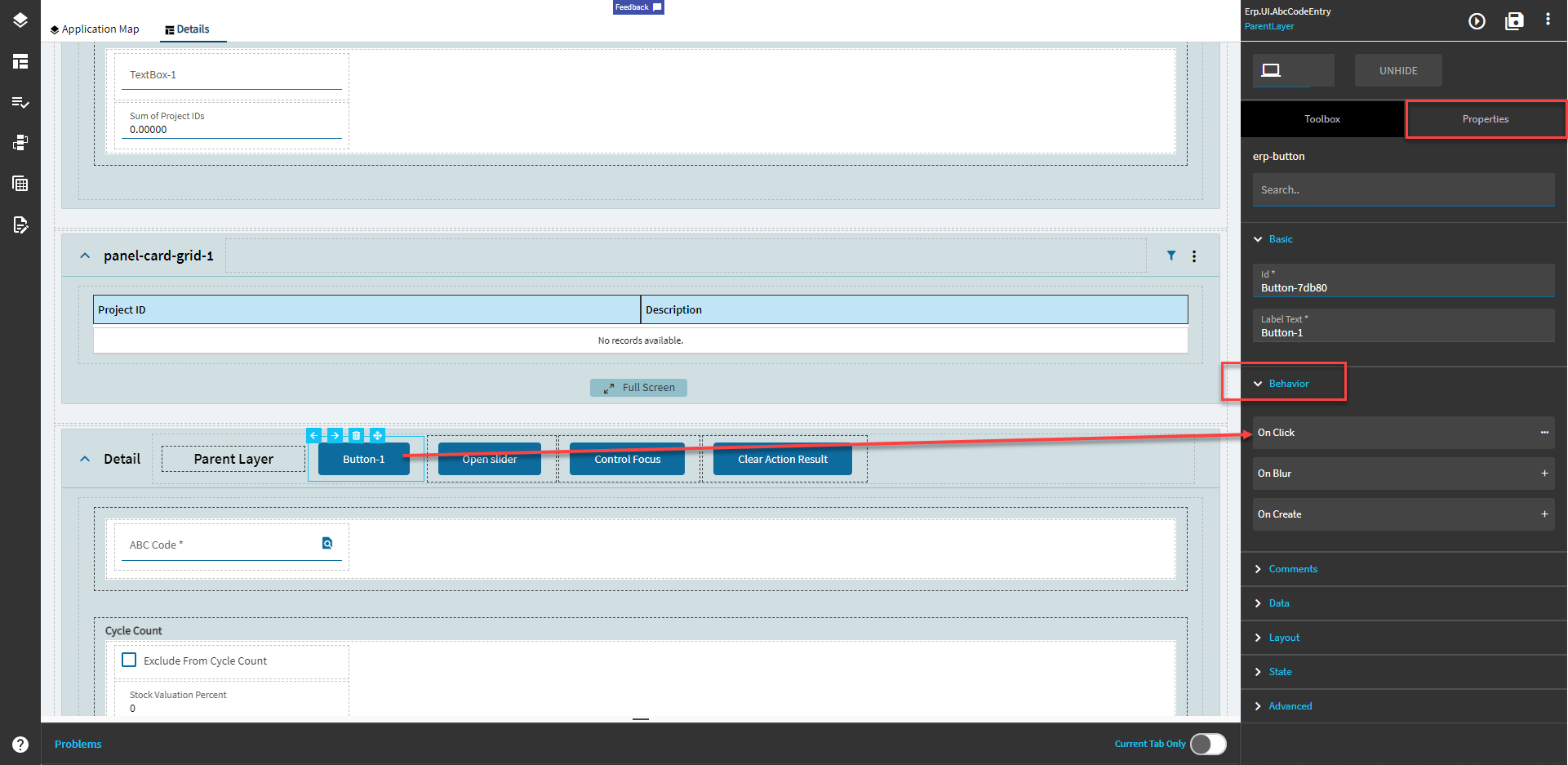

Just click the Behavior node in the Properties. It will generate the event for you.
