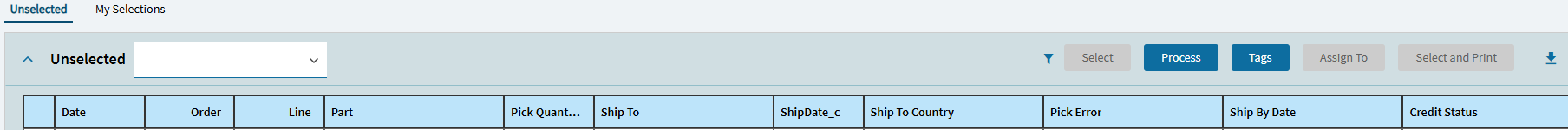

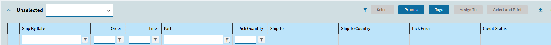

Hi,
I’m developing a customization of the material request queue.
In preview mode the following columns are displayed
I have then published the layer and the grid displays as follows (default display)
Is there an additional task to stop the default columns from displaying?
Thanks,
Andrew.

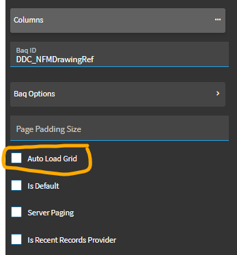

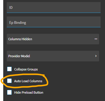

Do you have this setting checked under your grid model? If so, it may over rule your “columns” settings and pre-load them on its own.
There’s also another similar setting in provider model. I would make sure that one is unchecked as well:

I checked the checkboxes mentioned, and they were all unchecked.

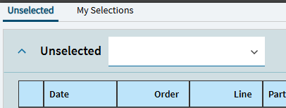

What about your “view options”? It looks like you have a “View” created because the “View” drop down is visible… but there’s no view name.
What settings do you have in there? (there’s another “Auto Load Grid” setting in there. If you’re not using your Views… you may have one in there that you could delete. Perhaps that’s creating some kind of conflict.

That is a different story.
I created a view and then deleted it - which has left behind the view drop down.
This is a known bug and one I’m hoping will be fixed before we move to the new interface.

Back to the columns… could you try specifically add columns to the Hidden Columns list to (hopefully) make them go away?
Shouldn’t have to do that… but, running out of ideas! haha.
