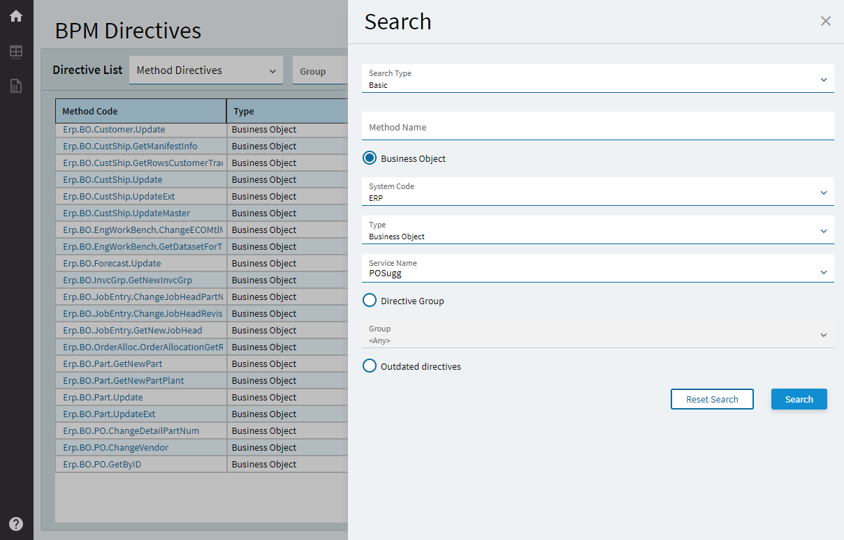

To further show my ignorance, can you tell me where I can find this method to customize it? Erp.Contracts.BO.POSugg.dll
In Method Directives, you can search for the BO service and method you need to customize.
In this case, the service is Erp.BO.POSugg … and you’ll have to do a trace to see which method is called to populate the data where you’re wanting to add this field.
I’m having trouble finding anything in there. Everything just points back to Erp.Tablesets.POSuggTableset. I did however find this in Extended Property Maintenance. Any chance I could do it from here?

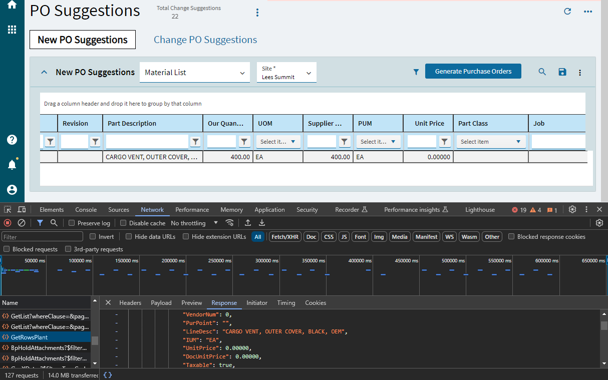

Looking at the grid from your original post…
Open your browser dev tools to the Network tab and refresh the screen.
On PO Suggestions there are a TON of methods that run right away, but only GetRowsPlant returns the data that gets populated into the grid in question:
Now we can create a Post-Processing BPM on that method (Erp.BO.POSugg.GetRowsPlant) to link the data from each line to its associated Part, grab the information from Part, and paste it into the dataset so that it’s available to be used on the grid.

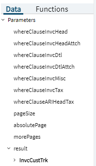

Where did you pull the original database fields from in order to add the new ones into it? I’ve searched everywhere and am not finding the same type of details? Or did you grab this from the details listed in dev tools?

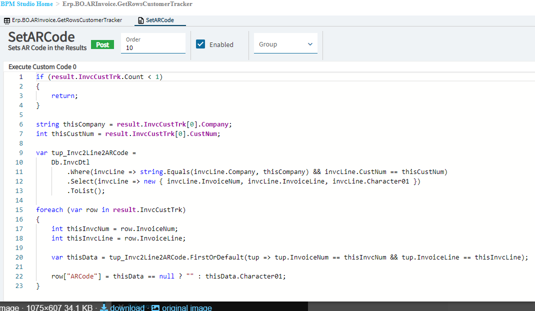

In a BPM, you have access to the data used in the operation performed.
In this case, the dataset returned after the operation is called result, and I added a field to each row of the result.InvcCustTrk table.
On the right side of the screen when editing custom code, there is a menu with all the BPM-related data available to be used.

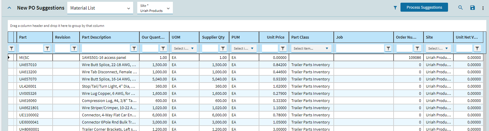

@Pgilbert I was just going to tell you how this worked in classic and hope it worked the same, but I took the opportunity to do the process in Kinetic since I had not before and it was very close to classic.
I added a field called volume_c to the SugPODtl table and then regenerated the data model. Reopened Epicor and the field showed in the data section @jwphillips showed above and was available to add to the grid in application studio. I added a NetVolume to the top part in my list and reopened the screen and got a calculation.
/* calc */
foreach (var ttSugPoDtlRow in result.SugPoDtl)
    var netVolume = Db.Part.Where(x=>x.Company == CompanyID && x.PartNum ==  ttSugPoDtlRow.PartNum).Select(x=>x.NetVolume).FirstOrDefault();
    if(netVolume != null && netVolume != 0)
      var volume = netVolume * ttSugPoDtlRow.XRelQty;
      ttSugPoDtlRow.SetUDField<Decimal>("volume_c",volume);
      Ice.Diagnostics.Log.WriteEntry($"Part {ttSugPoDtlRow.PartNum} volume {volume}");
