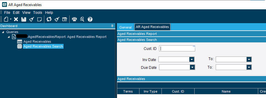

Straight grid dashboards with no other frills I was able to easily convert to a Kinetic application, but now that I’m working on ones with nothing additional than a tracker view I’m getting incredibly frustrated with Application Studio.
I just want a custom dashboard that doesn’t load results on open and instead presents the tracker view inputs to search, and then returns results. But when I convert my classic dashboard to a Kinetic application, it is creating the tracker view as a separate page and the fields are all grayed out when expanding the card. I can click the overflow menu on the results grid/page/card and select the tracker view name to slide out inputs, but that is after it has already returned results.
