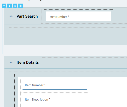

Application Panel with Single Text Box (For Part Number) for entry and display Fields linked to View

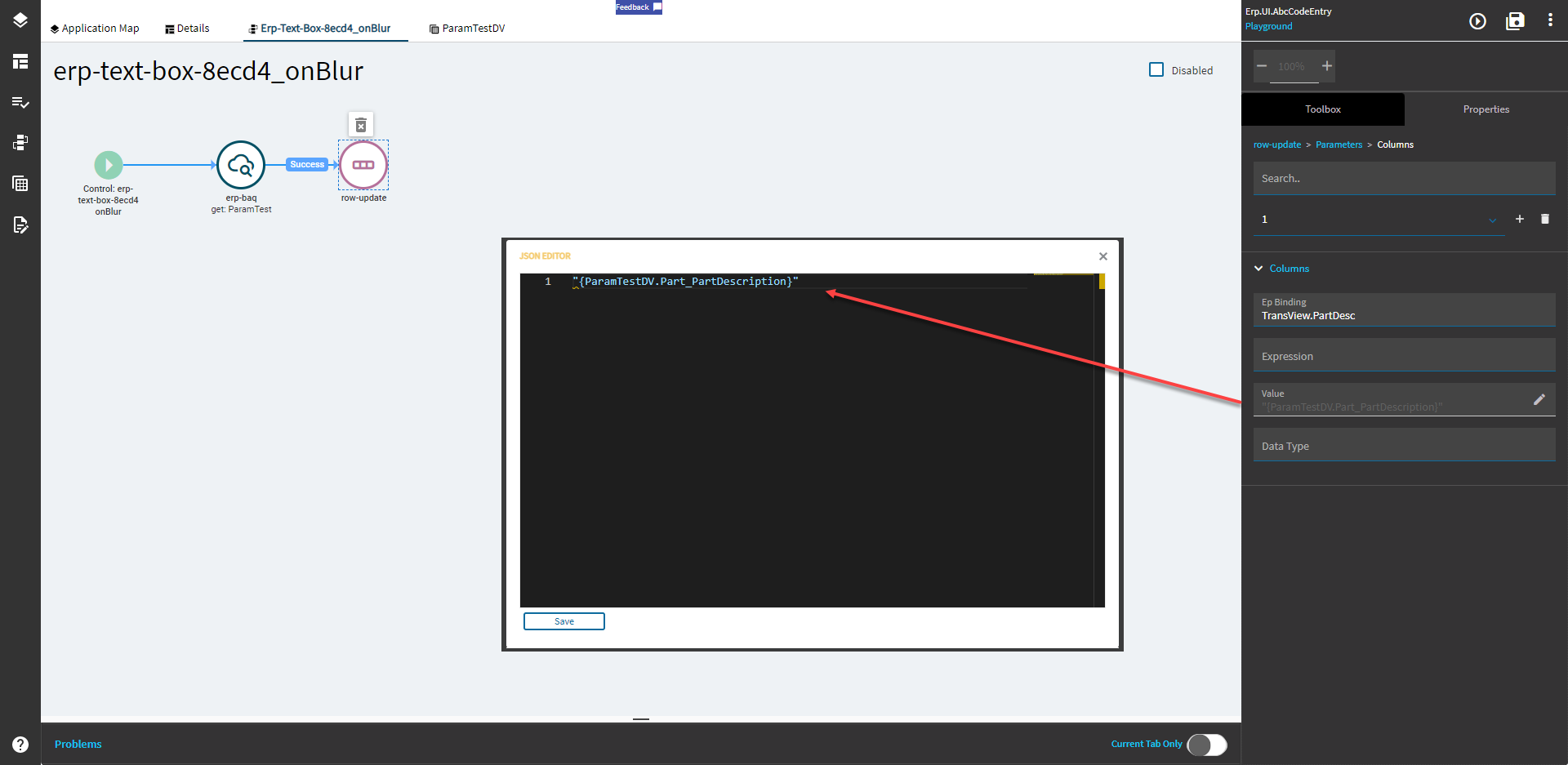

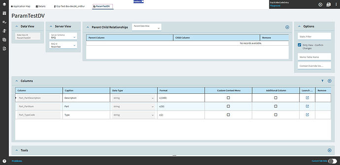

Create a BAQ Dataview to hold the results of the BAQ
Create the onBlur event from your textbox and load up the BAQ in GET mode.
Assign it to a dataview as well, so the data has somewhere to go. I suppose, technically, you could probably use ActionResult, but setting it to a defined dataview makes it easier to follow along and understand.
Set the parameter to be {DataView.Column} which is dependent on what you set the epBinding to for your textbox
I’m using TransView.PartNum. TransView is a runtime view that gets created on the fly. If you have a defined dataview, that’s fine too.
Not sure what you’re doing after the BAQ runs, but in this instance, I’m setting the result of the BAQ to the field TransView.PartDesc which is bound to the textarea below the textbox.

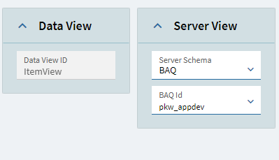

I have the Dataview:
and have two Panels;

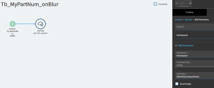

Event:
If I have an EpBinding set for the Textbox, it is un-editable at runtime.

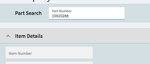

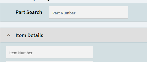

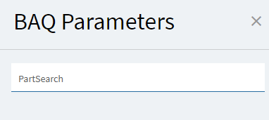

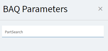

Right now when running I can enter Part:

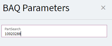

BAQ Parameter Window pops up:
Enter Part Again: (Press OK)

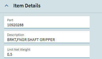

BAQ Runs and Items Display:
You are correct in that the ItemView is uninitialized until BAQ runs.
I end up with the same basic issue, where is the Textbox value stored and how to pass (reference) that in the BAQ parameter field and run without the popup…
The fact that the erp-baq has a BAQ Parameter section suggests that, I just do not know the syntax to reference the initial textbox value.

If I set EpBinding for the Textbox :

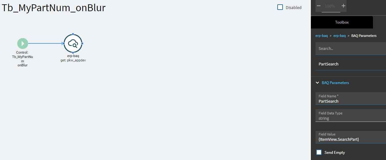

with the Event BAQ Parameters set;
and try to Preview, I can not enter any values in the textbox…
it’s just grey…
Should I be doing something with the Panel EpBinding?
The parameter value should have curly braces: {TransView.PartNum}.

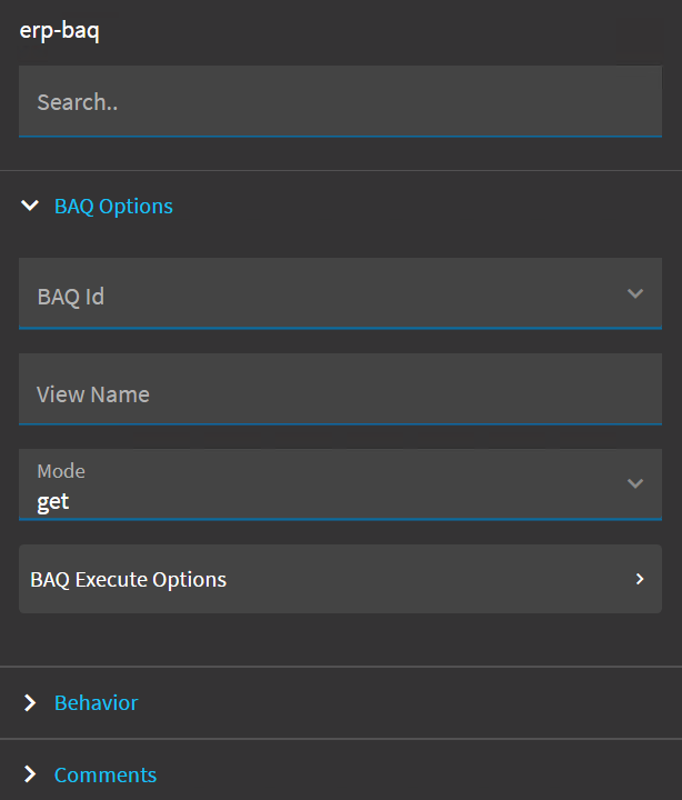

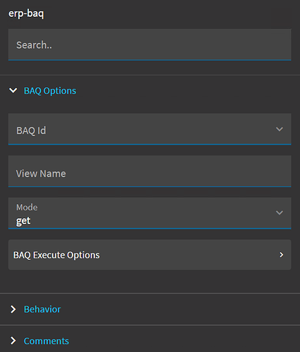

I can’t see BAQ Parametrs in erp-baq widget.
Is it because of version 2022.2.14? If this is a case - is it possible to pass parameter somehow to avoid slider?
You can, but it’s painful.

Starting from which version a “BAQ Parameter” option is available?
