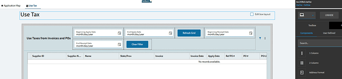

I am so close, but the layer that I merged the personalization is not working anymore. The column sizes are nice but I am missing my filters.
My layer used to look like this:
