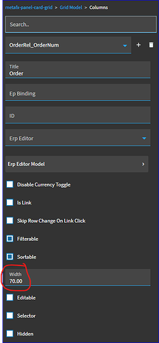

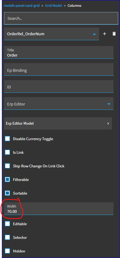

I don’t know if there is an option to “auto” size, but you can dictate the width of each column in Grid Model > Columns
Its a pain, but worth it.
The new autofit preview feature has been a big help and I agree that it is worth going through and setting the widths.
