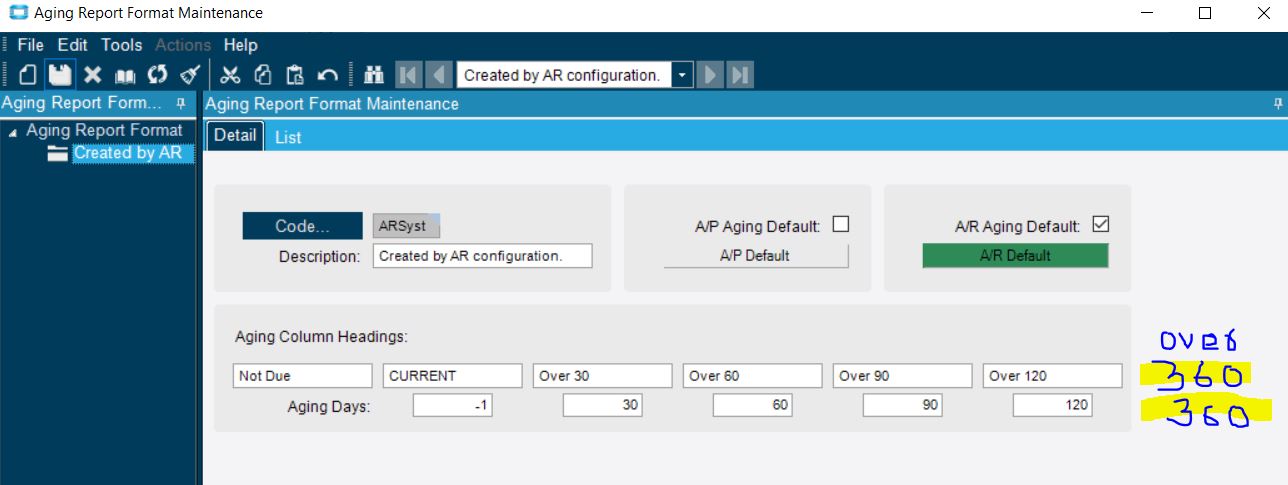

Dear experts, can we add UD columns in AR Aging Report Format Maintenance refer to attached screenshot
Nope. I’ve made aging dashboards for this though.
Dear Jason, We have created one baq for that, but data is not maching with AR Aging Report.
Could you share your baq?
