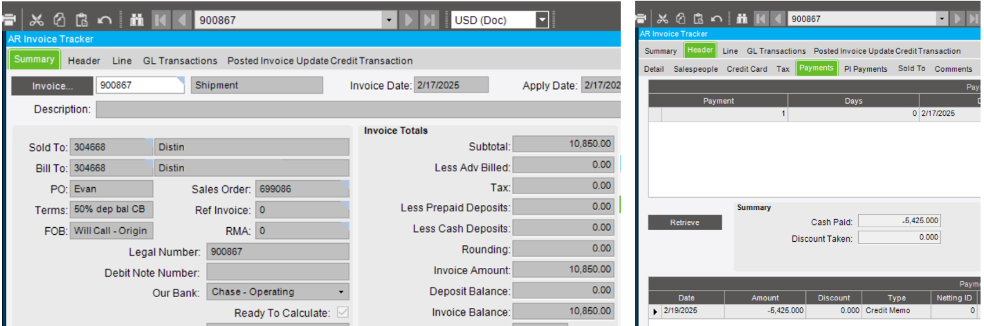

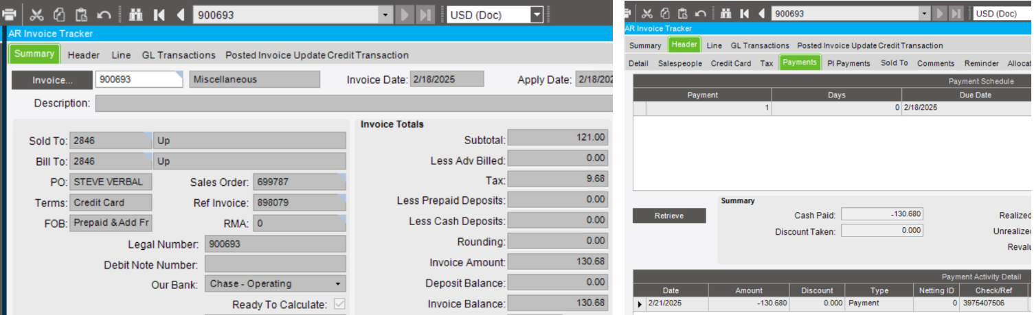

Invoice 900693: Invoice Balance on screen should be $0 instead of $130.68, as it has been fully paid:
Invoice 900867: Invoice Balance on screen should be $5,425 instead of $10,850, as a credit memo has been applied:
