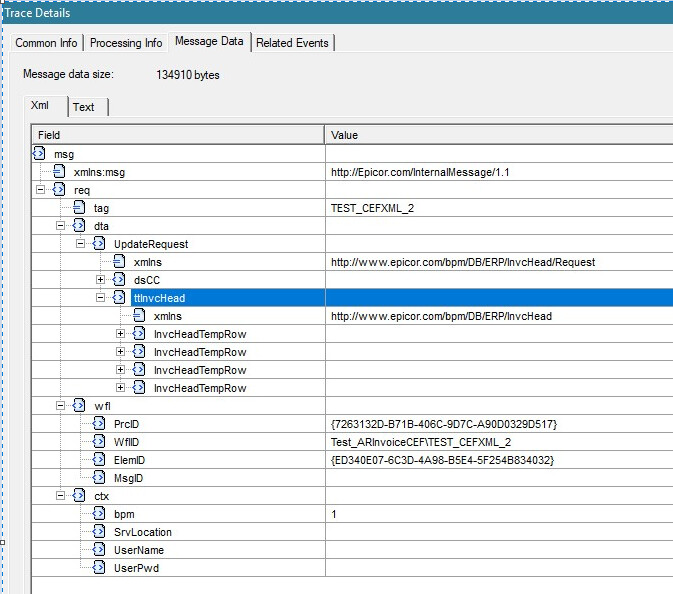

Remember that Document Tracking is your friend, it allows to review the state of the message as it goes through the processing (the output of the previous step in DT is what arrived into the element as its input).
@AMS Didnt quite work, as above if you could possibly explain this one?
You have the BPM Standard directive, correct?
It is called once per service call, before the call returns to the calling party outside of the web server, and receives all records that were changed within the table.
The call to SC Workflow mot probably gets all the records.
  • Check in SC Document tracking, on Start node – how does the message look - does it contain multiple invoices?
    If so – you may need to move calls to GetByID into a sub-wf and use synchronous or asynchronous cycling within SC (depending on whether you want to push a single XML per updated invoice or not, OR you could collect all invoice IDs you received and build a where condition for GetRows instead of GetByID – that would allow you to do a single call to the BO to retrieve the data, however it may not be the best idea if you need to post XMLs separately.
    Note: if it might happen that 1000s of invoices are processed in a single call and trigger the BPM directive, something more creative might be needed if you need to consolidate them in a single XML file.
@AMS
Yes its Standard Data Directive.
I will give the SubWorkflow a go now.
Just to note though the START node has 4 entries (TempRow’s). 2 for each invoice i post. (This was 1 entry when posting 1 invoice.

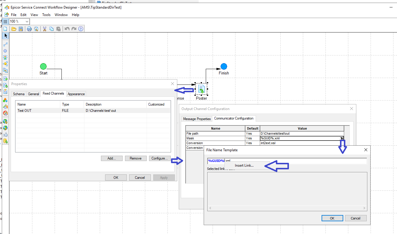

  • Changing the file name of the XML files from GUID to InvoiceNum
  • The AddressList from Epicor i need to split into individual fields into the XML file.
If you go into the Poster element on the workflow and click configure, you can get to the file name.
There, you can use XPath to pick data from the message to use within the file name.

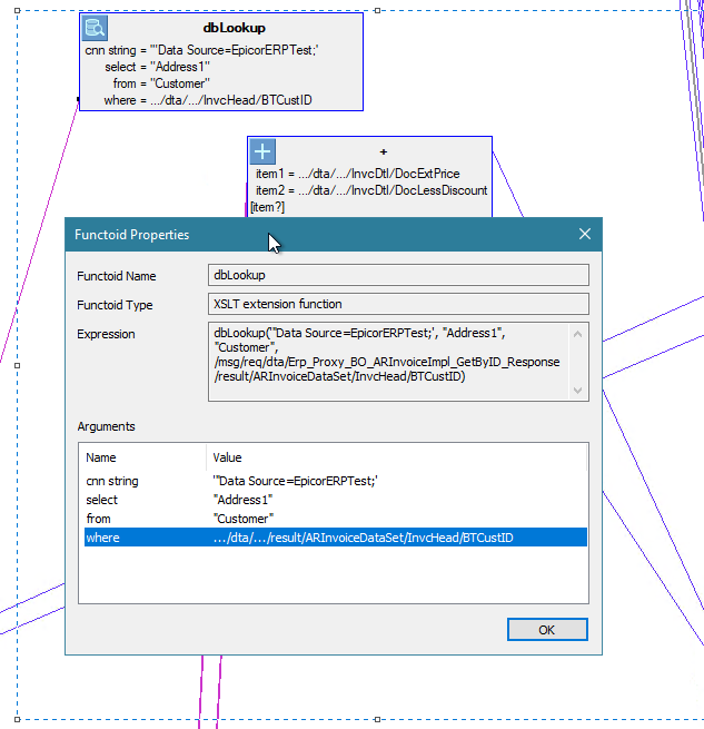

I have come across a Functoid which can lookup an Epicor table and select a field based on the CUSTID from the workflow dataset. I am unsure on how to configure it correctly though…
Do you have any idea on how to correctly call the SQL database from here?
Hi Ricky,
What is the AddressList you mention and what is the goal you need to achieve?
dbLookup functoid goes directly against the database you specify and returns data.
Each time it is called from within the XSLT transformation, it opens a connection, retrieves data, and returns it into XSLT.
It is not a good choice from perf point of view if multiple calls are expected to be performed; DB Operation element is a better one as it does a single hit against the database, however you may need more XSLT before/after.
Either way, hitting the database is the last resort, it is far better to go against BOs or any other kind of software-exposed interface.
For the dbLookup, if you need to apply a where clause, you need to build it using concatenation and feed it into the where clause of the dbLookup, I think – something like this.
Note – building SQL using string concatenation is error-prone, as it opens you for SQL injection.
Within DB Operation, when you build the SQL statement, you can use so-called safe links to the message data, which escape the value and wrap it safely for SQL.
Note that the table name for customer data in Epicor database is Erp.Customer.
The one without the schema (or, more correctly, dbo.Customer) is the view that only exists if there are UD Fields on the table and is joining the main table and the _UD one.
Mentioning this because I see Customer on your screenshot above.

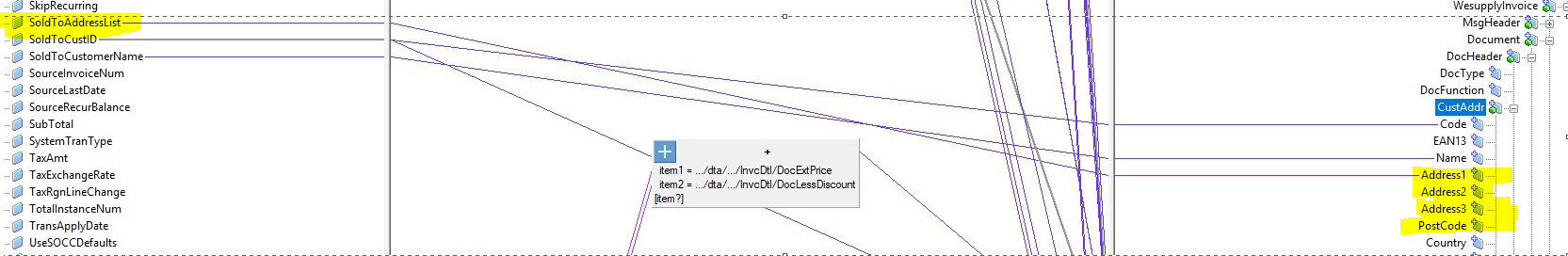

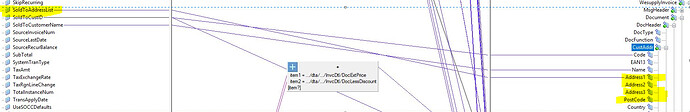

@AMS Thanks for the explanation, i don’t really want to be having this workflow read from the database as it will have to do it 15 times per XML file and then 100 xml files will be produced.
Epicor uses Address Lists rather than Address1, Address2, Address3, State, ZIP (They are available in the database though) The XML im trying to create requires the Addresses as individual fields.
As per Below: Epicor Data on the left, XML schema on the right.
Oh, so, it is not a loop, you need to extract the first part of the AddressList into Address1, the second into Address2, , the fourth into PostCode?
@AMS Yes, thats right.
