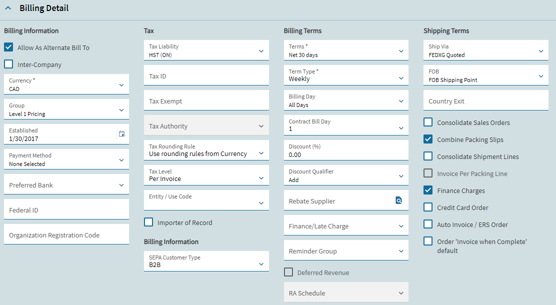

Hi Hally,
Here is example of setting in customer maintenance,
Do you have any idea?
Kelly

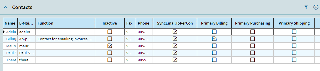

This is the contact setting:
I don’t know what “sync email to per con” mean.
Sorry, what I was asking really was which is the flag that gets the system to automatically print and send the invoice.
Based on the screen shots it does look like it’s a SSRS reporting and breaking issue.
We would need to look at configuration of the report styles related to the invoice print.

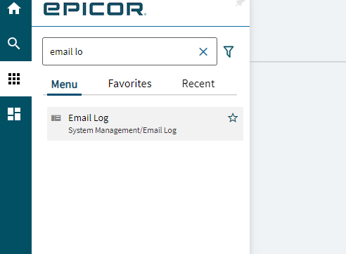

It is very hard to diagnose from this end give. It requires someone to look at how the invoices are printed/emailed from kinetic. If and if it is using an SSRS Routed report style then that would be the first place to look. As well as the SMTP log (if your version has that). If you can observe the two emails going to the customer then it is an Epicor issue if it is not then it is a problem down the line and IT need to get involved.

  • SMTP Log (to prove it is coming out of Epicor twice)

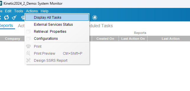

  • Finally check if there is not some scheduled task that is sending the invoices and it was created twice. Use the option to Display ALL Tasks in system monitor.
    Diaplay ALL Tasks
As mentioned I don’t know what version you are on to know if you have the smtp log tool. So you may have to defer to IT to get that information if it is not available in Kinetic.
This is what the menu item looks like
