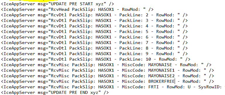

If you use Client WCF it actually handles the BeforeImage and stripping everything out from the dataset.
If you invoke a BO from a BPM it doesnt handle BeforeImage and it also sends the entire dataset to your PRE BPM:

Which makes calling a Business Object from a BO sometimes tricky. Nontheless. I wonder if Epicor Functions can use the BO.Proxy or if someone who calls multiple BO’s in a eFX needs to really, really know what theyre doing (havent tried yet).
