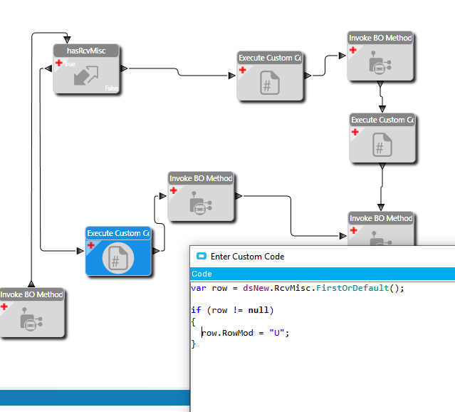

I’ve done Custom Code for many years and have been giving Widgets a try lately, only to stumble upon limitations and limitations… For example RcvMisc.RowMod isn’t accessible via Set Field but you can set it fine via Custom Code. That among many other things simply seem not to be getting any love from Epicor.

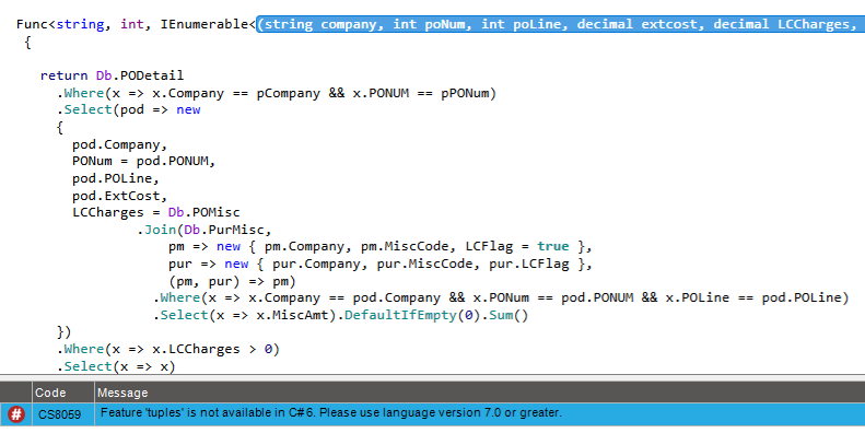

Also why are we still stuck on C# 6 compilation; can’t even use ValueTuple :slight_smile:

When you have to use Custom Code just for RowMod or the following BO doesnt work :slight_smile:
I think I do have a custom code widget to set it to U if I recall correctly :rofl:

Haso I was trying anything to get the RowMod to stick and this finally worked so I don’t know what to say.
Man, even I gave up on widgets for the RowMod, and I am Mr. Anti-code. It’s actually EASIER to read
MyDataset.LaborDtl[0].RowMod= "U";
than it is to set up and troubleshoot the fill table widget.
