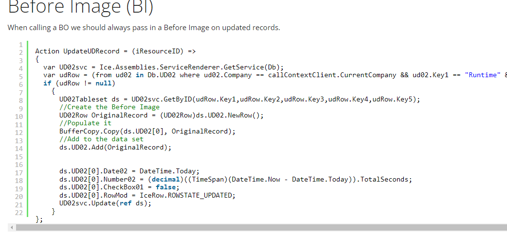

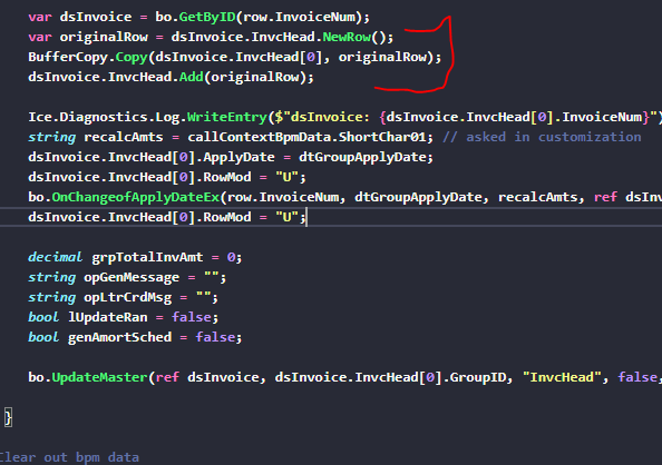

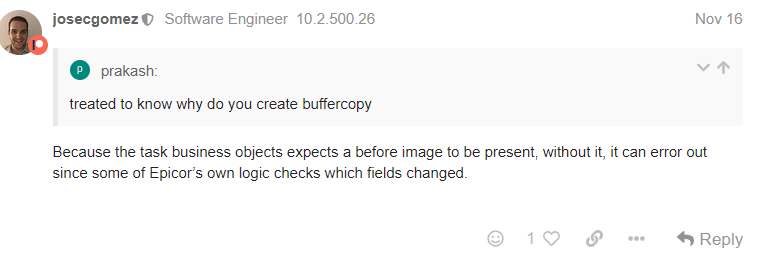

BeforeImage is when you are in a POST and you do GetByID and you make a change, before you call Update or UpdateMaster and sometimes other Methods… you need to create a copy of the row, basically your own RowMod ā€œā€ blank and then you make changes to second copy of the row RowMod ā€œUā€.
If you don’t certain methods will fail, they kind of require both. Epicor uses this technique throughout all of their BPMs. Example from SDK
Its not always update that only requires it others too.

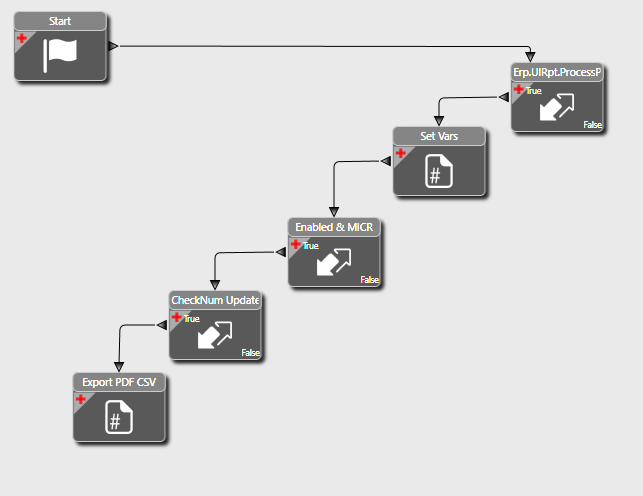

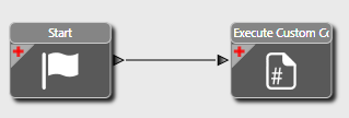

I do like widgets or coding in blocks, it also lets me visualize the BPM Flow better. I do appreciate your time SAD. I am not bashing widgets; actually I want to use them. But I feel like I can’t without cluttering my flow with ā€œhacksā€. :slight_smile:

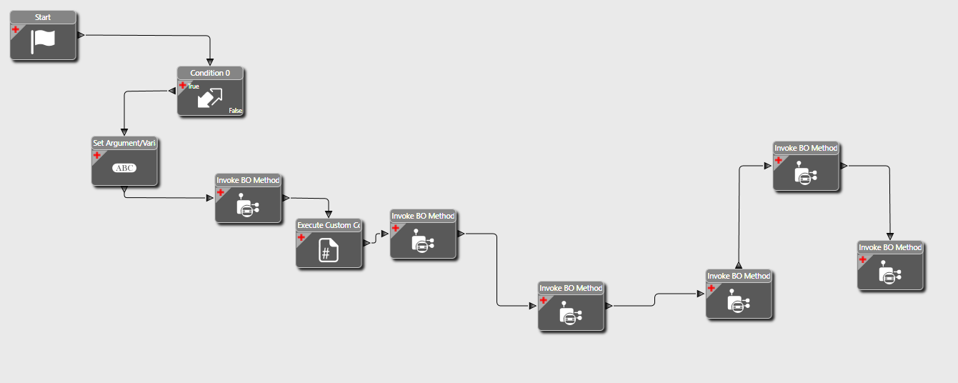

I’ve done plenty of:
I do prefer this more:
I want to get to this:
But I always end up with pockets of Custom Code :stuck_out_tongue:

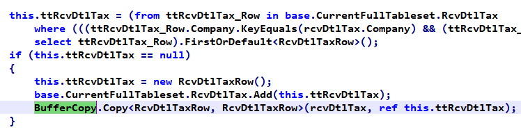

Just in case, modern versions (probably starting 10.2.700 or 2021.1) support BufferCopy-like stuff to clone the whole tableset.

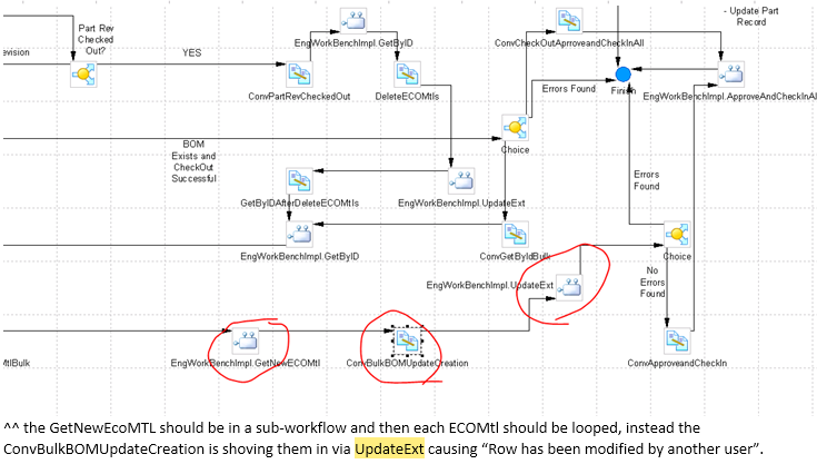

One last note on UpdateExt. I do know it does Multiple. But we have stumbled plenty of time with it causing a Row has been modified by another user… especially when we did alot of Service Connect. So switching to a loop and individually calling Update resolved many of those headaches.
I dont f with UpdateExt anymore I am all the way Update; lol
