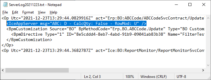

  1. It occurs only when a smart client proxy is used (probably web-ui was updated to support this mode too). Calls via REST, Service Renderer, naked service-methods do not have such ā€˜magic’
  2. This behavior has no relation to PRE (or any other BPM-specific things). It is just about client-to-server call convention.
  3. Also, ā€˜Epicor’ sends not only the updated tables but all parent rows for modified rows.
  4. All above is true only for tableset parameters with ref modifier. In the case of ā€˜normal’ parameters, even client proxies send whole tablesets.

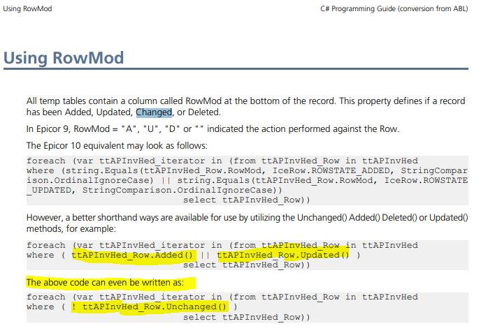

Could you please point me to the exact place in the guide? Changed == Add|Updated|Deleted since E9 (AFAIR).

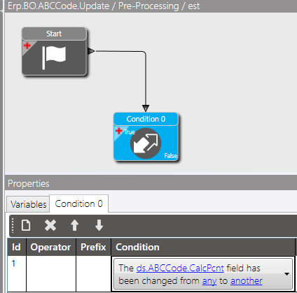

Wrong. Filter works only for the True exit, and only till the next condition widget.

I understand that, I am not complaining that Epicor does it that way. I love it that way. I was pointing out that when you use a Widget in a POST and you invoke the same Update method you get different outcomes which dont align with Epicor’s usual way, when the Facade is called, you get different behaviour than what Epicor usually would do from Smart client; not to rely on that.
For example I’ve seen folks do if (ttOrderDtl.Any()) { ... } when a ipTableName isn’t present they check if the ds has that table to indicate its probably a OrderDtl update. That is what the Epicor trace showed them. But little did they know is that calling Update from a POST or Service Connect would mess up their PRE since it would send ttOrderDtl, ttOrderRel, ttOrderWhatever - just be cautious id say.
In addition since it doesnt include a BeforeImage when your facade fires the following would for example not work:
The saying Just do a trace and you will know what Epicor does and repeat it isn’t necessarily accurate if one thinks the behavior will be the exact same, atleast when using built-in widgets vs Custom Code.

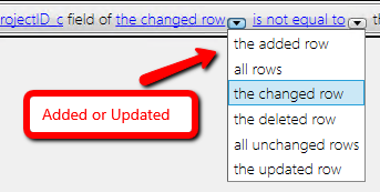

Since Changed is actually !Unchanged when the code is generated, based on that Guide we all started off with when coming off E9 to E10 - it was taken was !Unchanged() is Added or Updated.

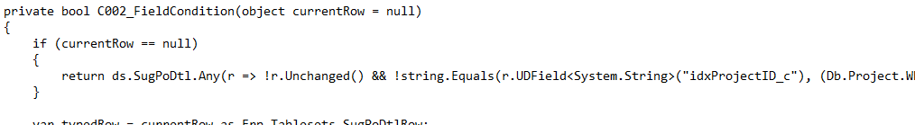

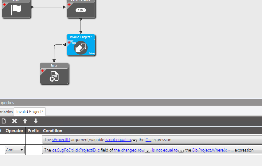

Here is an actual BPM that I have currently have in Production that would exception on Delete:
The fix is to have a condition before that to check for Added or Updated or maybe add an option so we can select Added || Updated in the dropdown :slight_smile:

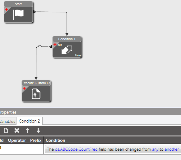

You are correct. I was wrong. Not sure if I recalled this from the past using Custom Code after a Condition.
For sure trying to access Unchanged row in Custom Code after a condition won’t work… but you do that rarely anyways. Condition after Custom Code or a Chained Condition works fine.

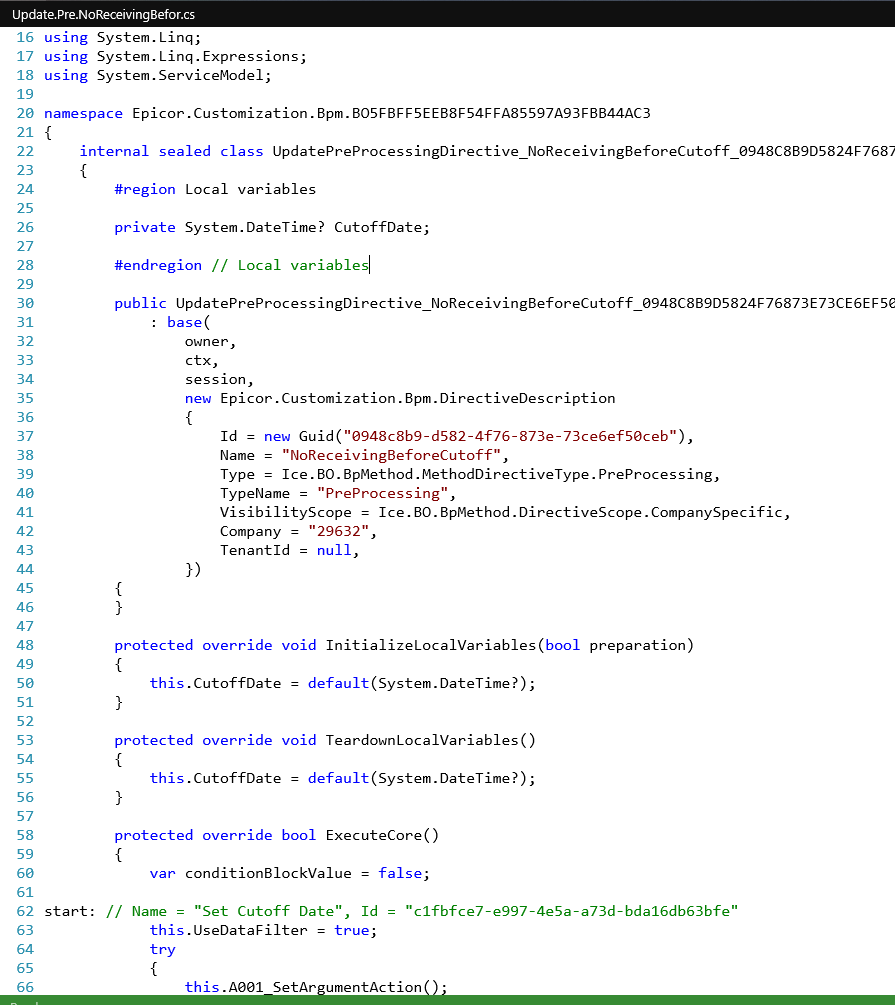

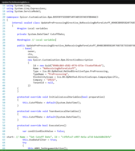

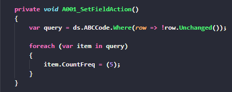

There kind of is one… If you look at the code that gets generated when you use widgets, it is a great way to learn. Haso was just posting about this in another thread.

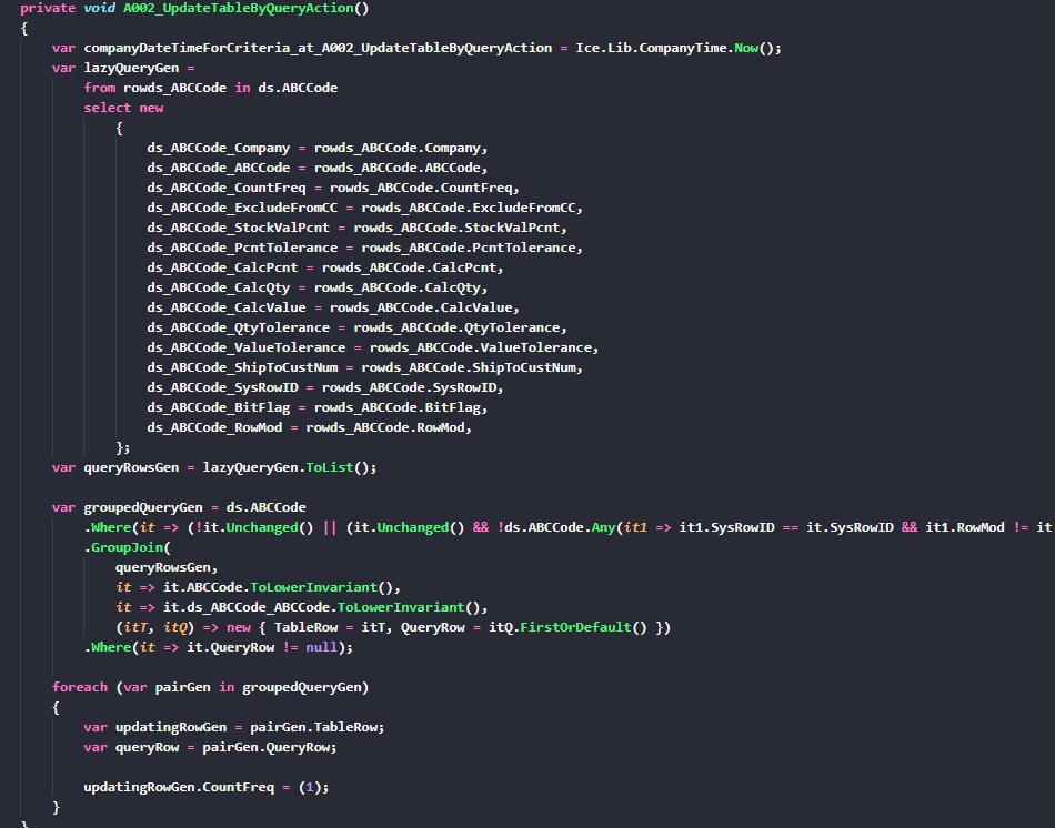

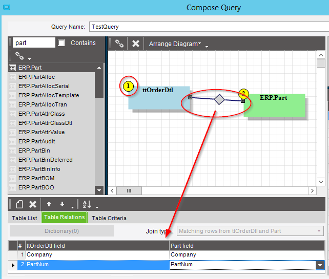

Here is one that scares me the most… Many people who use widgets join ttTable to RealTable little do they know is that it brings the entire RealTable into memory.
Its just natural to use the Compose Query that way
