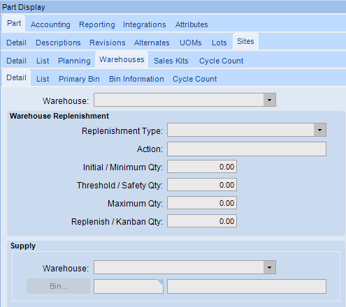

As @utaylor said Epicor would expect you to have different sites set up for these locations. If that isn’t an option, I think the best you could do out of the box would be to utilize the Warehouse Replenishment settings on your parts and use the Replenishment Workbench and the Material Request Queue to facilitate movement between buildings.
