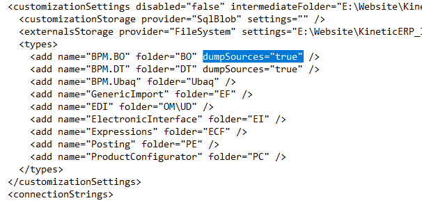

Atleast in Kinetic 2021.2 they are not being generated by default anymore and there isn’t any documentation of why this was taken away and how to enable it. If someone has this changelog let me know
Turning it back on :heart_eyes:
Some investigative Reflection work…
In your web.config simply add dumpSources=“true” to each individual Type you want to get sources generated for.

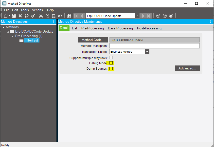

I guess another way to enable them without enabling it globally is via:
no, no, real admins do it the hard way
So if you’re on public cloud without server access the dump sources checkbox essentially does nothing? Or is there a way to get to it as a Public Cloud user?
