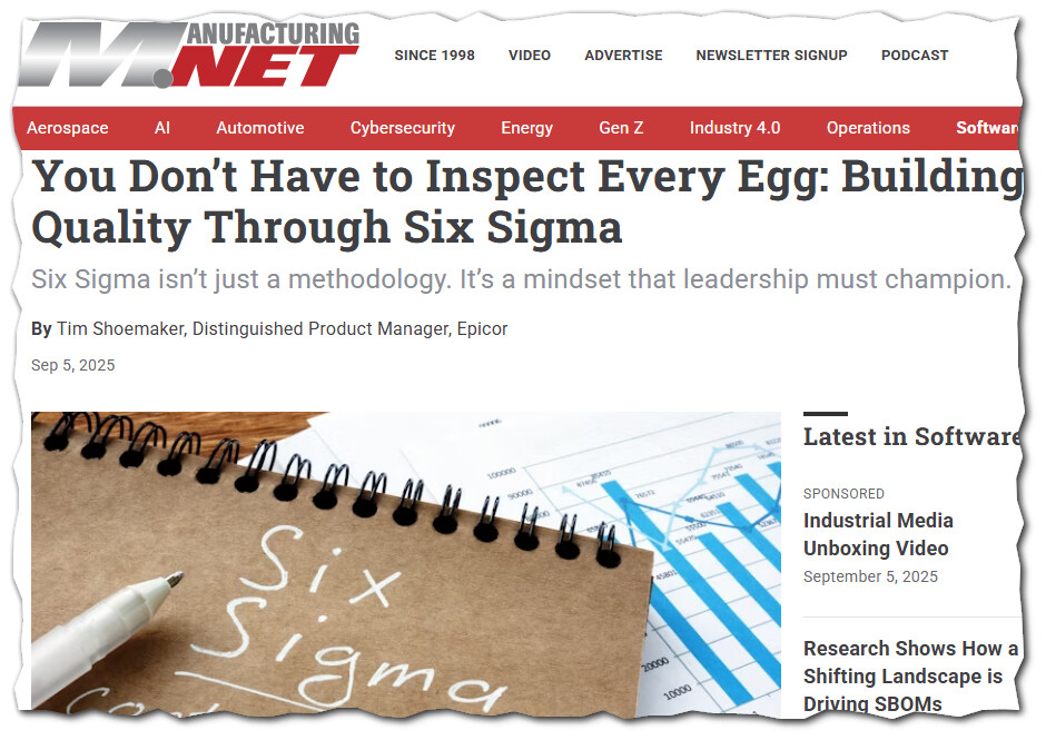

Article: You Don’t have to Inspect Every Egg: Building Quality Through Six Sigma
Check out the article written for You Don’t have to Inspect Every Egg: Building Quality Through Six Sigma illustrates how Six Sigma is less about inspecting every item and more about designing processes to minimize defects from the start. Using the analogy of checking a carton of eggs, it explains how Six Sigma applies statistical methods and data-driven analysis to reduce variability, achieve consistency, and eliminate waste in manufacturing. The foundation of Six Sigma success is clean, reliable data—enabled through ERP and MES tools—and a culture where every employee, not just the quality team, takes ownership of quality. With AI amplifying data insights and Six Sigma providing structured process control, organizations can drive continuous improvement, but ultimately, leadership must embed quality into both systems and culture.

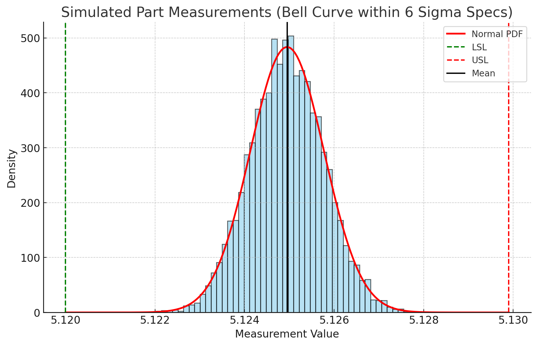

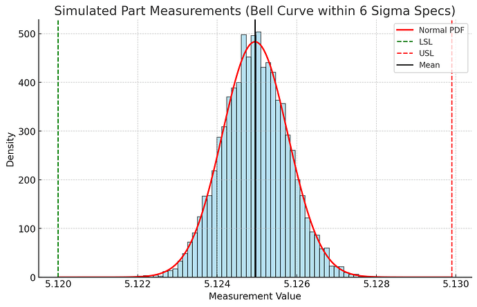

Here are some examples of 6 sigma… the first graph shows where the six sigma values are… if your process is consistant, then there there should be less than 4 chances out fo a million that your parts fall outside of the tolorance:

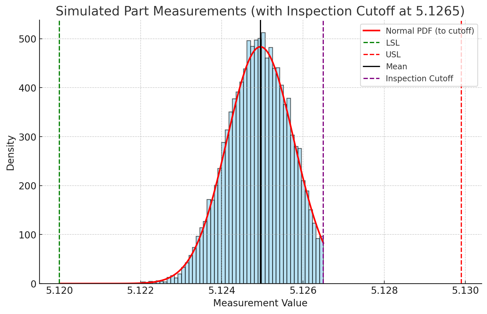

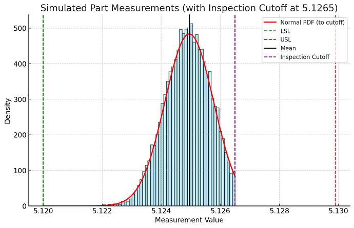

BUT, sometimes, companies will “inspect” quality into their product. In this case below, the inspector rejected all the parts that were above 5.1265. The bell is good on one side, but not on the right side. you know that the inspector COULD make mistakes and accidently miss a bad part:

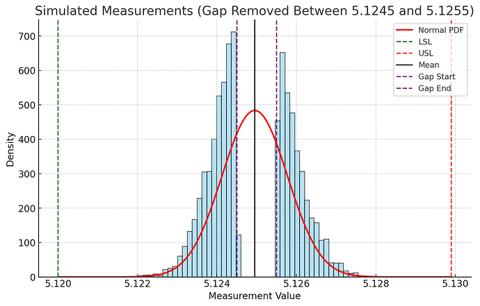

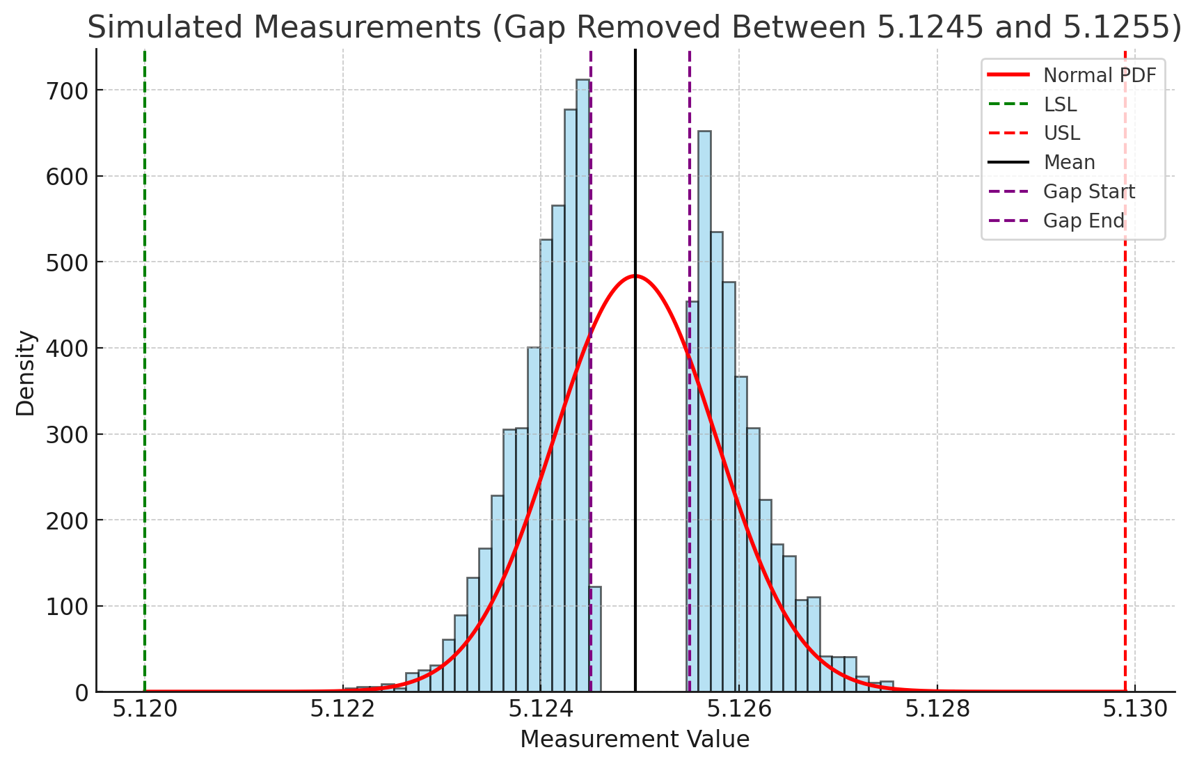

NOTE that if you use SPC, you can also find out if your supplier is taking the good parts out and sending them to another customer. One time we had a supplier send us a bunch of parts, and we took the measurements… found a graph that looked like below. Director of QA rejected the lot, not because the parts were not in spec (100% were in spec) but because the “good” parts in the center were all removed. The supplier was inspecting out the center parts and giving them to another customer for a higher price.
