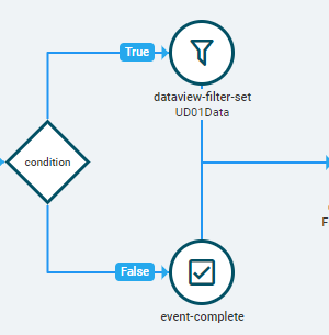

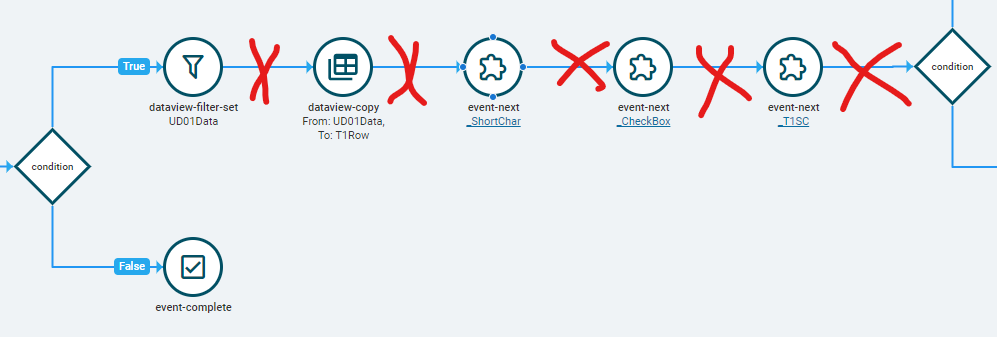

Just figured out there is a little hiccup with this though. I added in the condition and set false to event-complete and after saving and going back in, the system added a connection off of the event-complete.
If you just delete the connection, save, and close out, it will be back again the next time you open it. You need to delete and reconnect all up until, in my case, I came across another condition.
