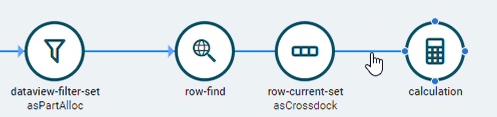

  1. If the widget you add automatically gets an arrow, you delete the arrow and add it to a new widget there is no arrow just a line between the two widgets not allowing you to save the application. You then have the delete all the widgets and not have the arrow automatically connect to save your work.

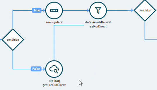

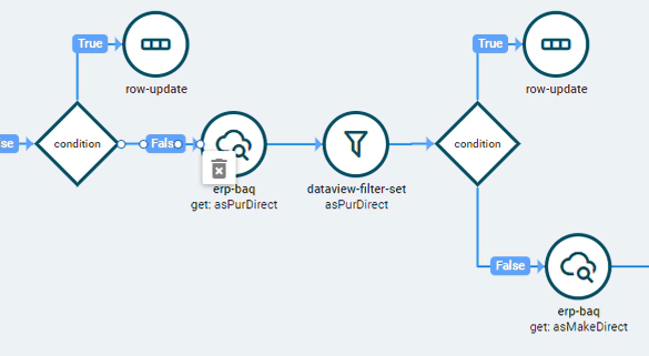

  1. Sometimes my logic would not make any sense when previewing the application. Using the developer tools it just made no sense seeing it go through the logic. Example: a row would hit a condition statement and would be false. It would go through the false logic and then go through some of the true logic…Refreshing the page after saving would result in Application Studio reorganizing my widgets to look nicer. Great!..Oh wait they added an arrow to my widgets resulting in what I was seeing in the application preview. I have also had experiences with Application studio deleting my logic resulting to me losing hours of work. This was not a result in me not saving my work for the record.
My Logic:
Application Studios Revised Logic Upon Refresh:
