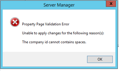

I am trying to assign our company to our license file and when I do I get the below error:

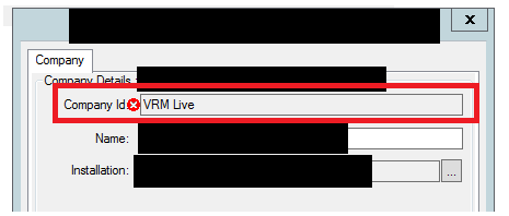

But when I look at the Company ID field that is giving the error, it is grayed out and I am unable to edit it. Does this mean we need to request another license file from Support or is there a way to fix this? I wouldn’t think it would complain about spaces but it is. Our Company ID in our current 905702a environment does have the space in it for the Company ID so something in 10 doesn’t like it which seems stupid.
Not sure if we can just delete the company in the EAC and create a New company with the same parameters but no spaces in the Company ID and then assign our license to that company? Will doing this affect any of our data?
Deleting the company will affect data, so, I wouldn’t recommend that.
Please open a Support case and request the datafix @ E905 that can remove spaces from the CompanyID field. You’ll have to remigrate to E10.x however.

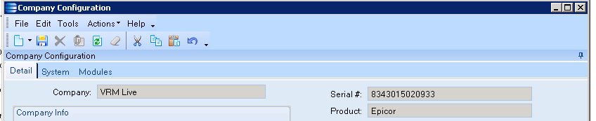

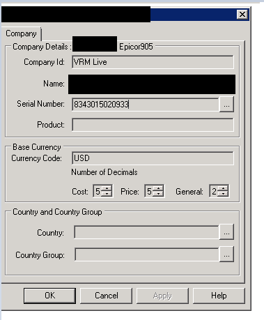

we are live on E9.05…heres a pic of the same screen in our E9 EAC.
Heres the Company config from LIVE…also showing the space.
