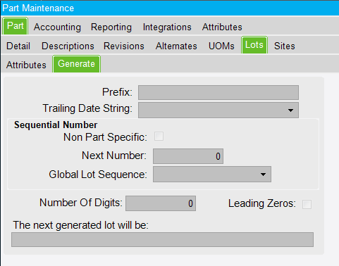

There are a couple of places where you control Lot generation. From your post, I am assuming that you want to do this on the Part level. Let me know if I am incorrect.
Open up Part Maintenance, load up a part you want to Lot track, then go to the Lots/Generate tab. This is where the settings for lot generation are. The important field to note here is “Non Part Specific”. If you want one global lot sequence for ALL parts, check it off. If you want individual lots per part, leave it unchecked.
This looks like exactly what we are looking for, thank you so much John! Right in front of my face, should have seen it sooner…
