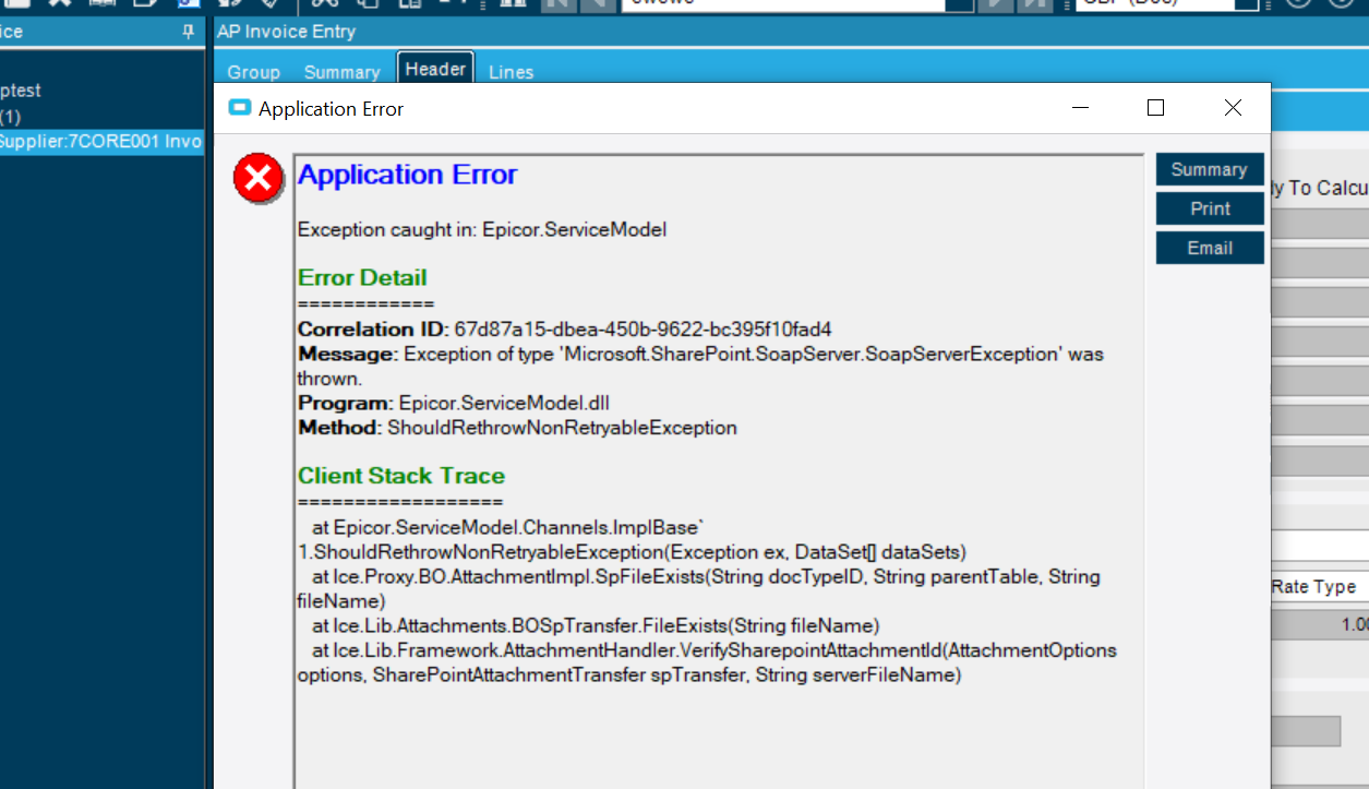

Hi,
when we attach a file(pdf/excel) in poheader, we are receiving below error message. we have sharepoint as storage location.
the filename is unique and does not have special character.
we are in 10.2.500.5
please provide your insight in handling this issue.
Note: the sharepoint server credentials are verified and ok.

the event server error log is below.
Server Side Error
Server Side Exception
EpicorServerException
Correlation ID: c6a58922-7fef-4ec7-bf38-2cb166e7f7cf
Description: Exception of type ‘Microsoft.SharePoint.SoapServer.SoapServerException’ was thrown.
Program: System.Web.Services.dll
Method: ReadResponse
Original Exception Type: SoapException
Server Trace Stack: at System.Web.Services.Protocols.SoapHttpClientProtocol.ReadResponse(SoapClientMessage message, WebResponse response, Stream responseStream, Boolean asyncCall)
at System.Web.Services.Protocols.SoapHttpClientProtocol.Invoke(String methodName, Object[] parameters)
at Ice.Lib.SPLists.Lists.GetListItems(String listName, String viewName, XmlNode query, XmlNode viewFields, String rowLimit, XmlNode queryOptions, String webID) in C:_Releases\ICE\RL10.2.500.0FW\Source\Shared\Lib\Ice.Lib.SharepointHelper\Web References\SPLists\Reference.cs:line 435
at Ice.Lib.Attachments.SharePointAttachmentHelper.GetDocumentId(Lists spLists, String FileName, Boolean ShowErrors, Boolean deleted, String& ListID, String& ViewID, String& fileRef) in C:_Releases\ICE\RL10.2.500.0FW\Source\Shared\Lib\Ice.Lib.SharepointHelper\SharePointHelper.cs:line 561
at Ice.Lib.Attachments.SharePointAttachmentHelper.AttachmentExists(String fileName, Boolean deleted) in C:_Releases\ICE\RL10.2.500.0FW\Source\Shared\Lib\Ice.Lib.SharepointHelper\SharePointHelper.cs:line 799
at Ice.Services.BO.AttachmentSvcFacade.SpFileExists(String docTypeID, String parentTable, String fileName) in C:_Releases\ICE\RL10.2.500.0FW\Source\Server\Services\BO\Attachment\AttachmentSvcFacade.cs:line 666
at SyncInvokeSpFileExists(Object , Object[] , Object[] )
at System.ServiceModel.Dispatcher.SyncMethodInvoker.Invoke(Object instance, Object[] inputs, Object[]& outputs)
at Epicor.Hosting.OperationBoundInvoker.InnerInvoke(Object instance, Func2 func) in C:\_Releases\ICE\RL10.2.500.0FW\Source\Framework\Epicor.System\Hosting\OperationBoundInvoker.cs:line 59 at Epicor.Hosting.OperationBoundInvoker.Invoke(Object instance, Func2 func) in C:_Releases\ICE\RL10.2.500.0FW\Source\Framework\Epicor.System\Hosting\OperationBoundInvoker.cs:line 28

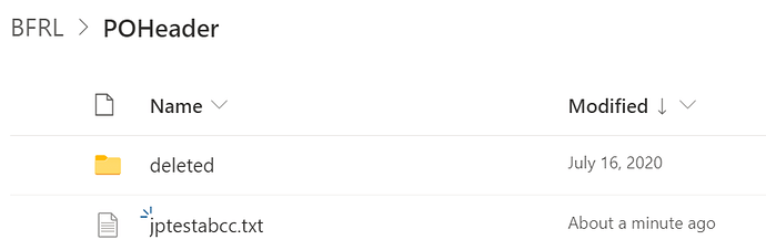

Can you use another company pointed to another SP site and check if POHeader attachements work \for other folderl? Probably something wrong with those 2K files…
hi @Olga
the attachment is working in another company (bfrl) and even run a sql query on xfileref counted number of records in poheader grouped by company. i picked a company having highest number of attachments, and attached a file, it worked (below image jptest*.txt uploaded via epicor).
but not working on company 304 poheader level attachment…:worried: :worried:
