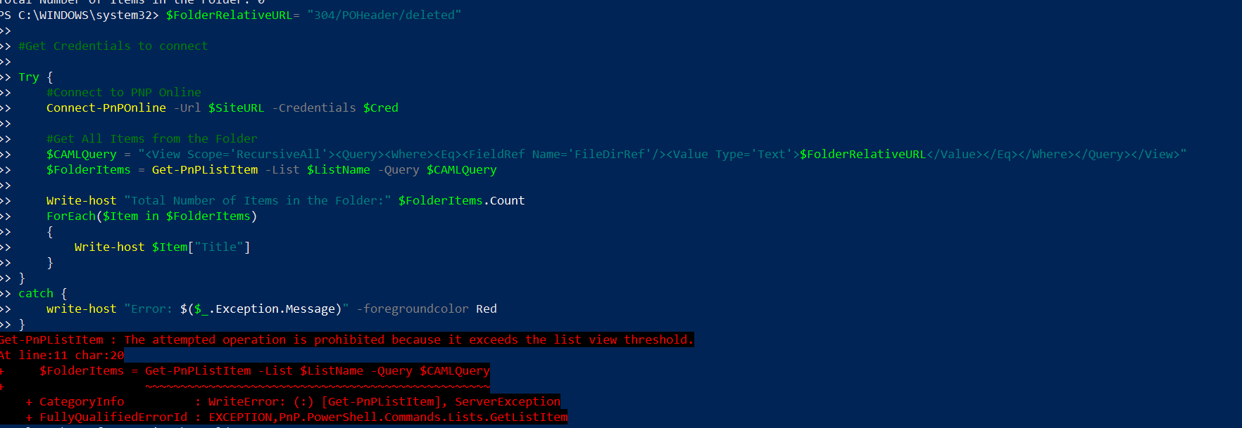

hi @Olga,

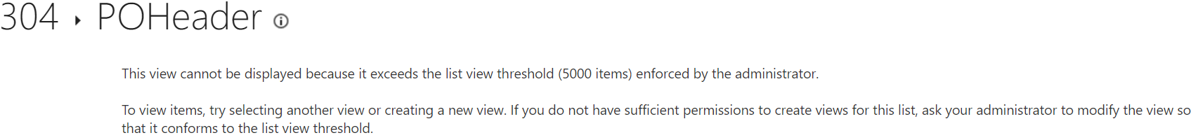

tried to list files in deleted folder, and having the threshold issue. the deleted folder only have 2 files.
I think this is the root of the problem. I donāt know why it is not working with 2 files, maybe there are some soft-deleted items that are not shown?
Probably this question can be answered by SPO support.
apparently we cannot change the sharepoint list threshold as we are not SP onprem

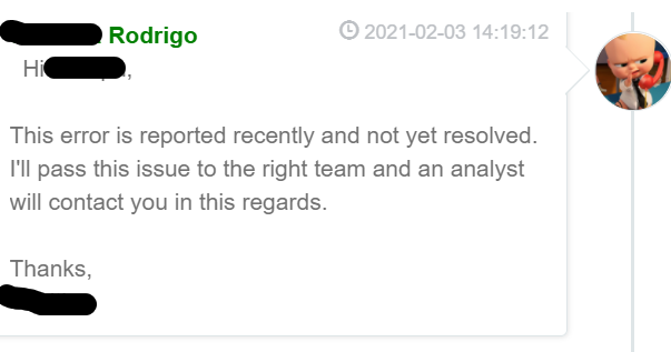

below epicor support response. case ref CS0002420513
I donāt think Epicor support can help you with Sahrepoint Online. The error is coming from you Sharepoint installation.

for instance, we have 13 companies in our system, the average number of PO raised is 1400 to 2100 per year.
the SPO have the threshold limitations of 5000 as well which we could not modify.
this mean our system will reach 5000 files in SP under POHeader over a 2.5 year period. thus, we will be caught up with threshold issue. how do we handle this situation? anything pipelined from epicor? or any other workaround?

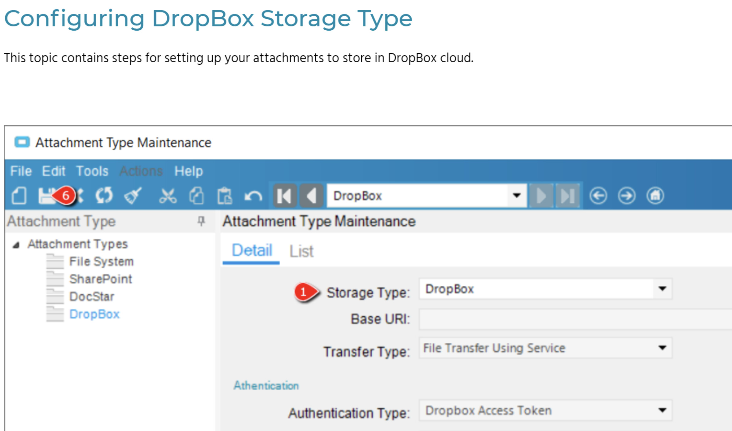

If youāre on 10.2.700 and you just want an archive of attachments and not the other features of Sharepoint (document types, security, retention policies, Microsoft Search, notfications, ā¦) then maybe DropBox is a better solution.
Oh, I should add that DocStar is a better dumping ground than SharePoint and DropBox.
