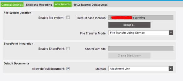

Karen,
Could you share a screen shot of Company Maintenance Attachments please.

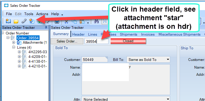

Reading the posts, I just thought of something else, the attachments are stored on the header, or the line, or the release. If you made attachment on line and click for header attachments you won’t see line ones. Could this be the problem?
Nancy

Yes, you wouldn’t see the attachment, Nancy.
I think Nancy’s latest, regarding attachments on the line vs header may be the answer.
I just checked the order that the user was saying the attachment disappeared from and Ta Da, the attachment is made to the last line of the order.
