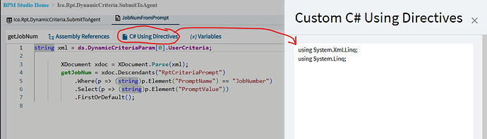

First goal was to get the job number from the UserCriteria in ds.DynamicCriteriaParam.UserCriteria. The data had many rows and at first, I could not parse out just the Job Number. The data is XML and I needed LINQ to XML. In the Using Directives, add usingSystem.Xml.Linq; and usingSystem.Linq;
The code to isolate only the JobNumber
string xml = ds.DynamicCriteriaParam[0].UserCriteria;
        XDocument xdoc = XDocument.Parse(xml);
        getJobNum = xdoc.Descendants("RptCriteriaPrompt")
            .Where(p => (string)p.Element("PromptName") == "JobNumber")
            .Select(p => (string)p.Element("PromptValue"))
            .FirstOrDefault();
This provided the JobNumber.
