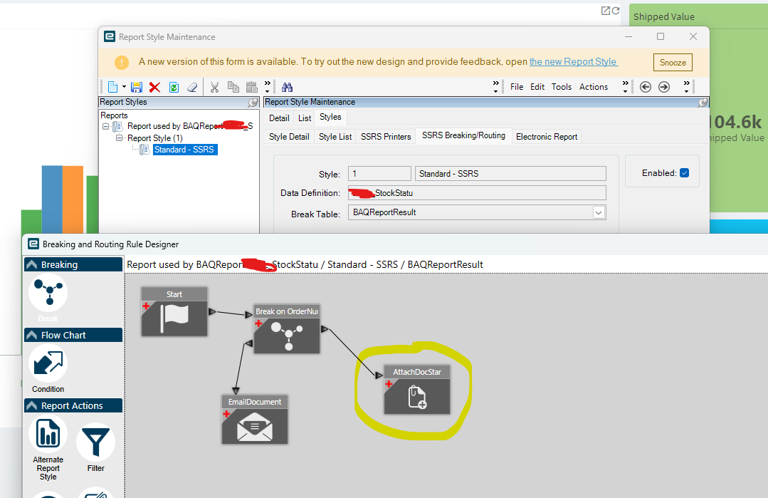

Hi, I am looking to store our documents in SharePoint rather than Docstar ECM (having major issues with their support and missing documents etc).
Manual attachments are fine but I am really hoping we can use something similar to Report Style Break/Routing to store files created by Epicor within a SharePoint library based on the Document Type ID but im struggling to find any methods.

Hi, i want to emulate the Docstar ECM attachment widget in the Breaking and Routing designer but instead of ECM I want to store the file in a SharePoint library.

Ok, I do not have the control I thought I did.
There is a BPM that is fired that you can override with the ecm attachment, however, I thought the check for if we have ecm was at the bpm level.
It is not, I can’t add that widget, so no firing the bpm to intercept.
If you want to attach the documents, we’ll have to find another intercept point that makes sense.
Attaching the documents is pretty straightforward once you have all the info about where etc.
