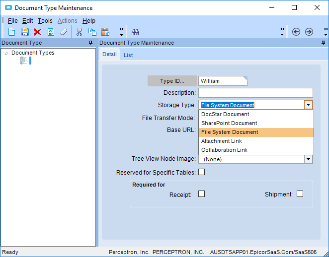

Never mind I figured it out. But I can’t find the “File System” you are speaking of.
So, by choosing file system, it wills ave a copy of the actual document to that location, correct?

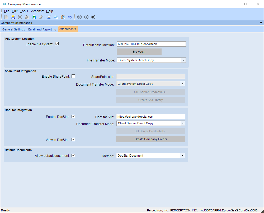

Yes. It saves it in the location listed in Company Maintenance | Attachments tab. You cannot control the folder structure. It’s based on the Epicor entity that you’re linking to and separates it out by company ID.

Great! So If enable the Sharepoint and create the Site library, it will drop the file sin that location, correct?
Scratch that, I’ll just use the standard file system. Thanks!
The downside of the File System is there is limited security. Everyone has access to all folders. Also, you cannot add meta data for searching of documents like you can with SharePoint and DocStar.
