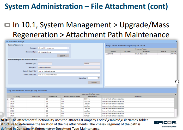

To fork this conversation a little (not much)… I have had a situation where I had to migrate from one server to another and ensuring all links were properly pointing to new locations was pretty horrific involving manipulating SQL tables with no user-friendly info. @aidacra, are you aware of any improvements in maintaining this structure of links and file associations?
As of 10.1.400.x there is a module to maintain the links to attachments via Attachment Path Maintenance.
Ask and ye shall receive! Thanks Nathan!
