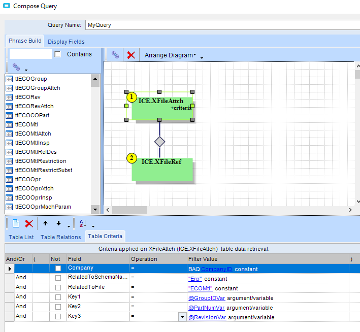

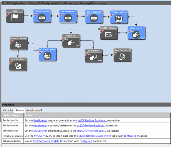

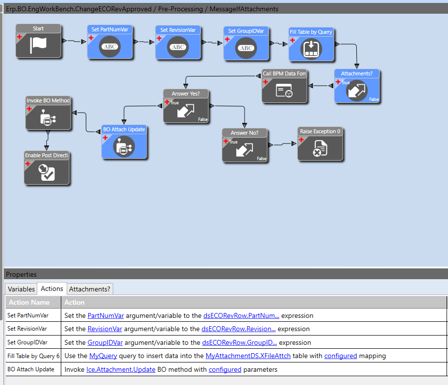

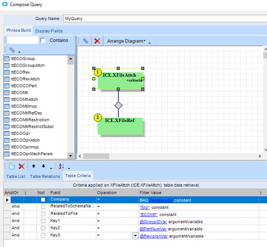

I have managed to get 95% of the way to a BPM that deletes all those auto attachments from the BOM in a Pre-Processing directive on ChangeECORevApproved. Here are some screen shots of the what worked for me.
I first fill an Attachment tableset variable with any attachments that are found in the XFileAttach table, then use Attachment.Update method with the RowMod set to “D” to perform the deletions. These are removed from the XFileAttach table for RelatedToFile = “ECOMatl” (not the original “Part”).

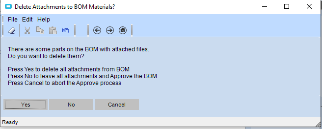

I have a dataform so the user can choose to have all the attachments deleted or not:
