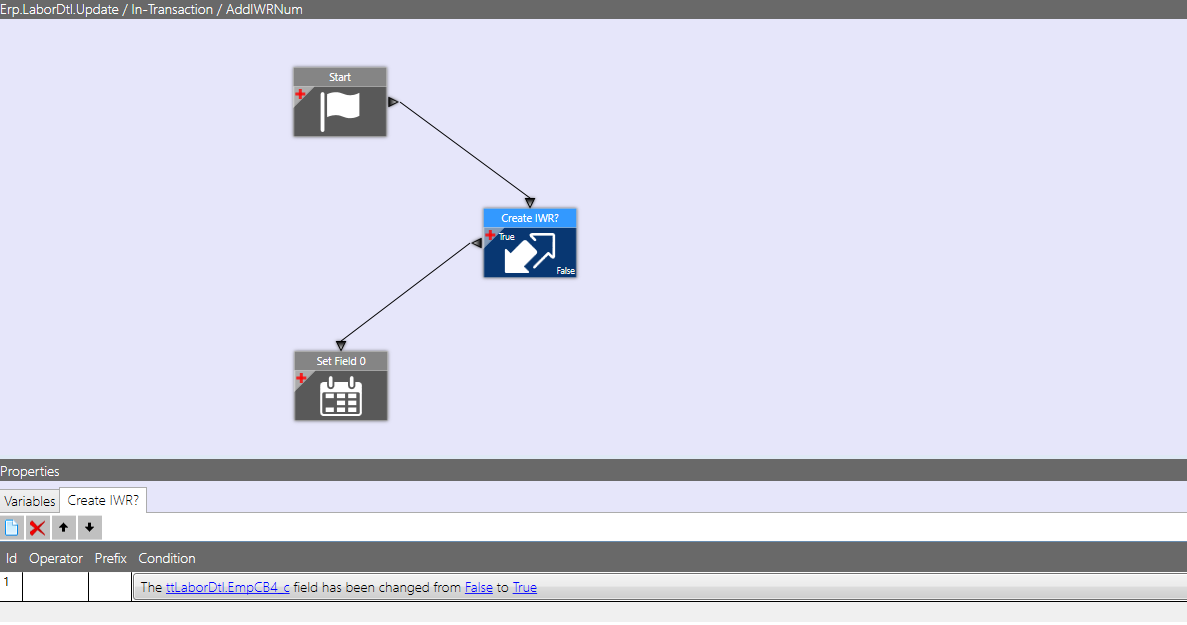

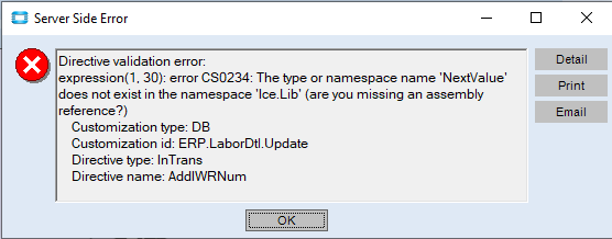

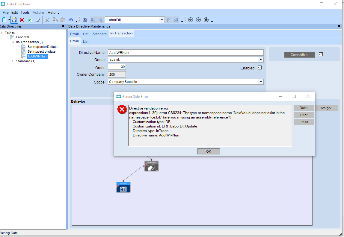

ahhh sorry that makes more sense… I saw maintenance and just assumed it was something else to actually change. I might have jumped the gun on the “no error” comment though…it compiles the code fine with the designer but when I exit and save the directive I get the following:

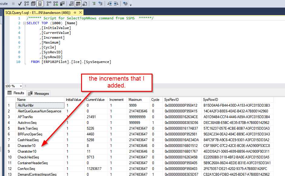

We do an auto sequence as well, but we chose to do it via a UD table and hold different sequence numbers per type of transaction. Example each of our finance groups (AP, AR, Cash, etc.) get an auto sequence number assigned to them. However, we wanted it controlled so we added rows to a UD## table. We use the Key1 field to assign it to the section of the system we want the number. We then pull the value from the UD table in a BPM based on the calling method, increment it by one, and store it into the field/object on the screen and update the value in the UD table to the new value. Then, when it is called again the process just repeats.
Just thought I’d add that for your information in case you do not want what the built in Ice.Lib does for you.
That basically what the built in library is doing for you. It’s just in a table that isn’t exposed the BAQ, but it’s in the database if you have access to the SQL DB directly.

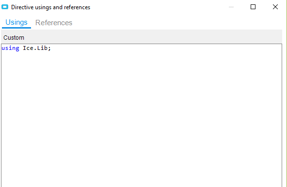

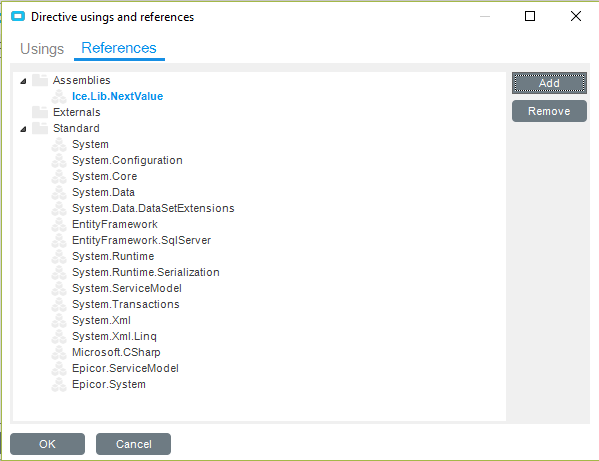

- add Assembly reference “Ice.Lib.NextValue”
- write using Ice.Lib;
Hi Surendra
I did both of those (well I already had the reference but didn’t have anything in the usings) and still gives me an error when saving
hmmm, no error for me. I’m on 10.2.200 though. Maybe a bug that they fixed?
gives me the same error…

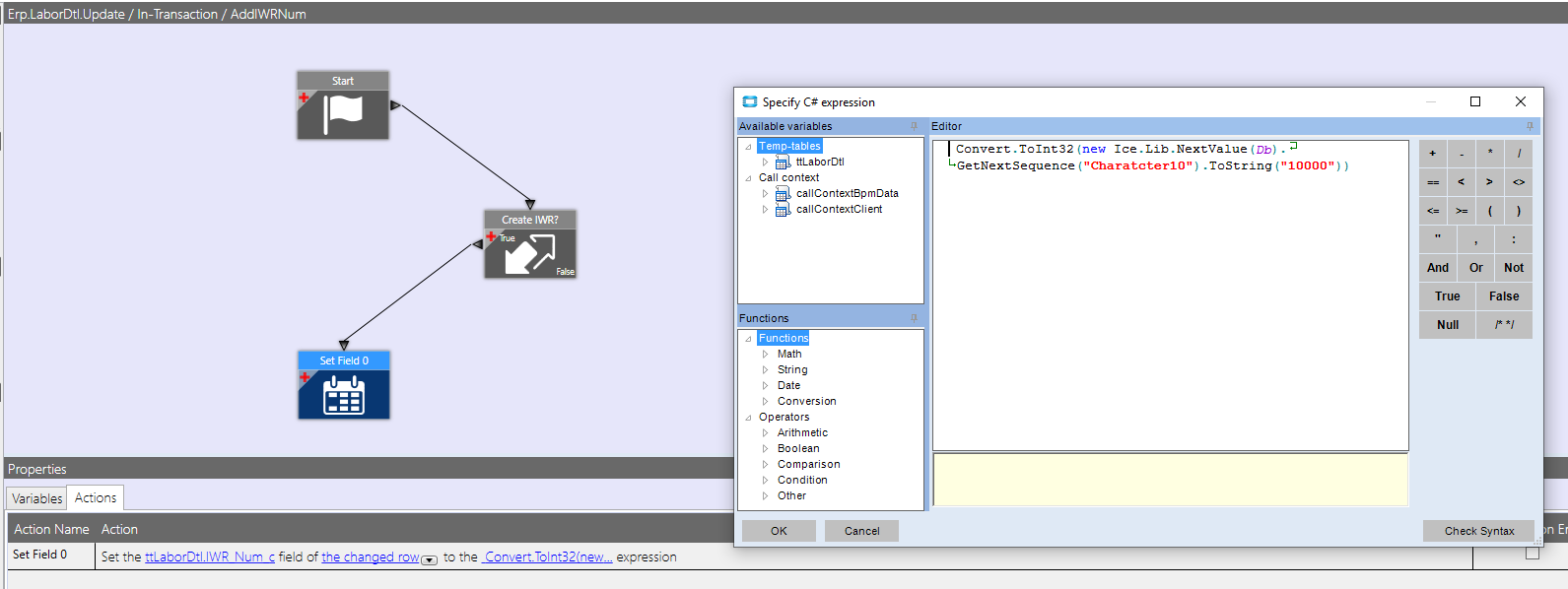

can you paste your final code here?
craaaaap you think that could be the problem?
Convert.ToInt32(new Ice.Lib.NextValue(Db).GetNextSequence(“IWRNum”).ToString(“10000”))
Referencing Ice.Lib.NextValue
and using Ice.Lib;
