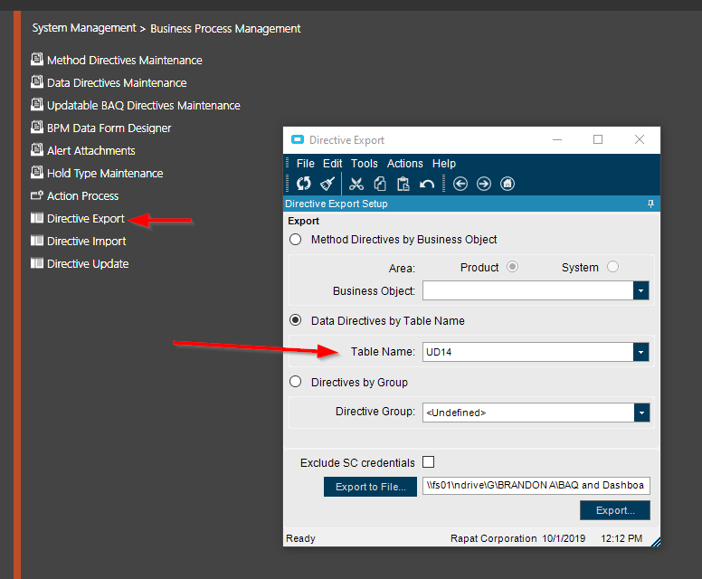

Can you save with the enabled unchecked? After you do that, export the BPM and post it please.

I don’t seem to have export as an option? actions is grayed out…
