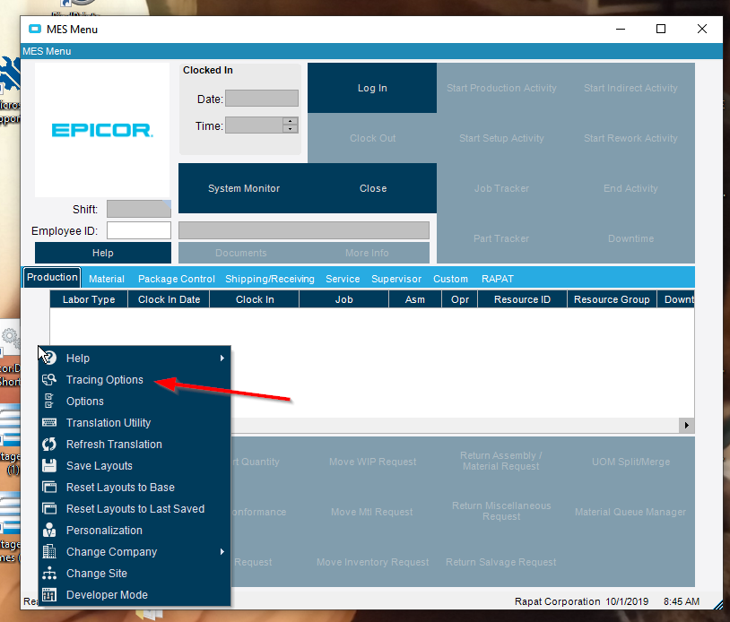

Message boxes should work on the MES screen. You can do a trace in MES as well. You can do a trace in MES, right click on some gray space and it should show up here.

A BPM on the LaborDtl table? Am i going down the wrong path looking at Method directives?
Can’t believe I didn’t know that was there…rookie move…
Ok so I have the tracing…but there is A LOT of junk coming back. I have closed the system monitor, just trying to comb through what was returned
