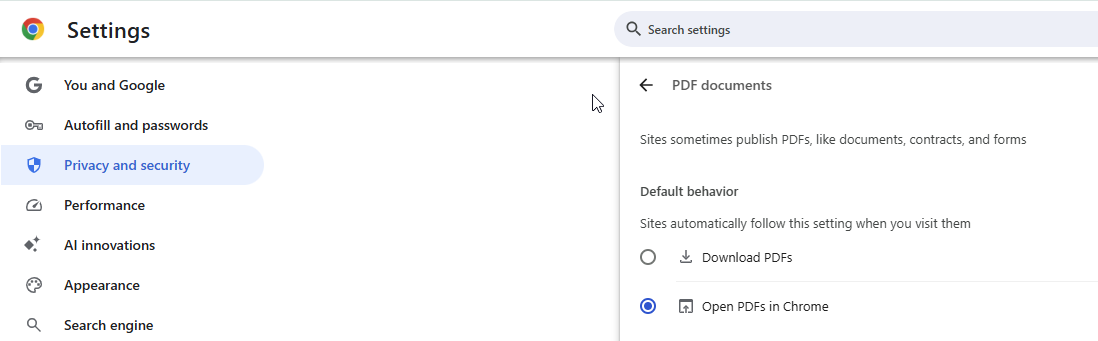

I don’t know if this will help but did you check this setting?
Yes this is set to open PDFs in Chrome. It opens the first report that I printed but does not open the “AutoPrinted” report that is supposed to launch after it.
Yeah I think its because the autoprint is happening server side so it doesn’t know how to get to your browser. That’s my super sophisticated technical understanding of what is going on.
