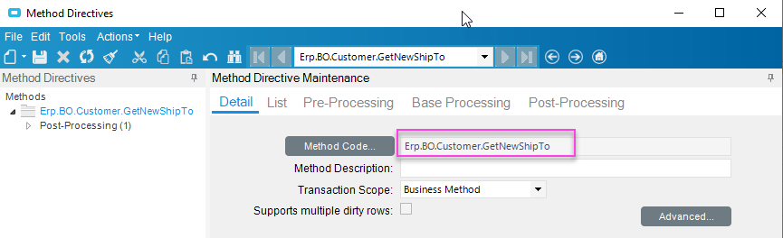

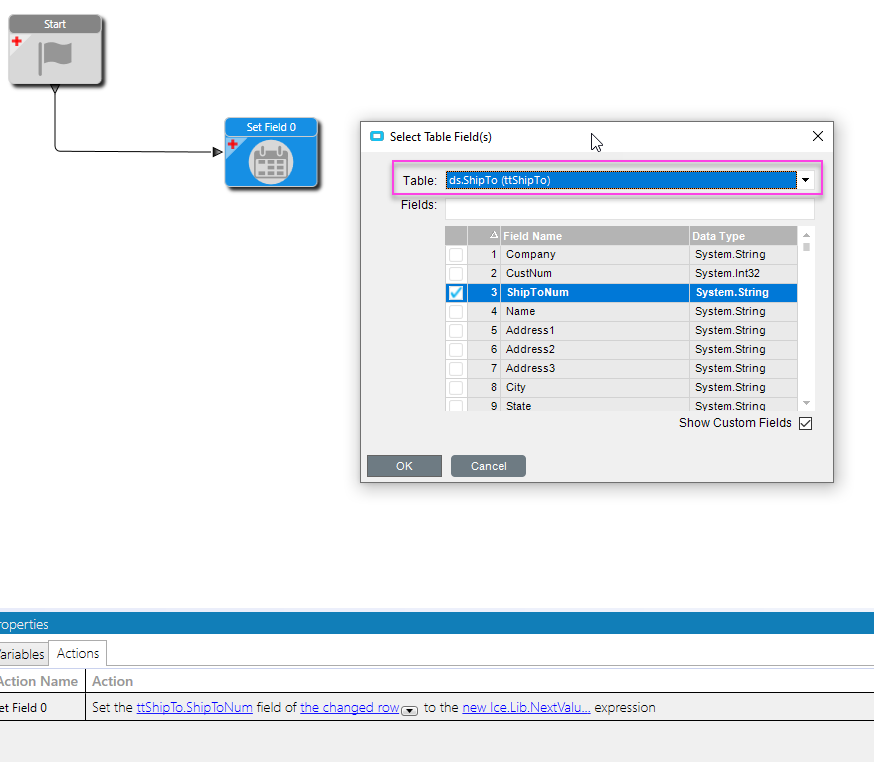

Just figured it out
The Method Directive is the Customer.GetNewShipTo NOT the Shipto.GetNewShipto
Then I had to select the ttShipTo table in the Set Field item
