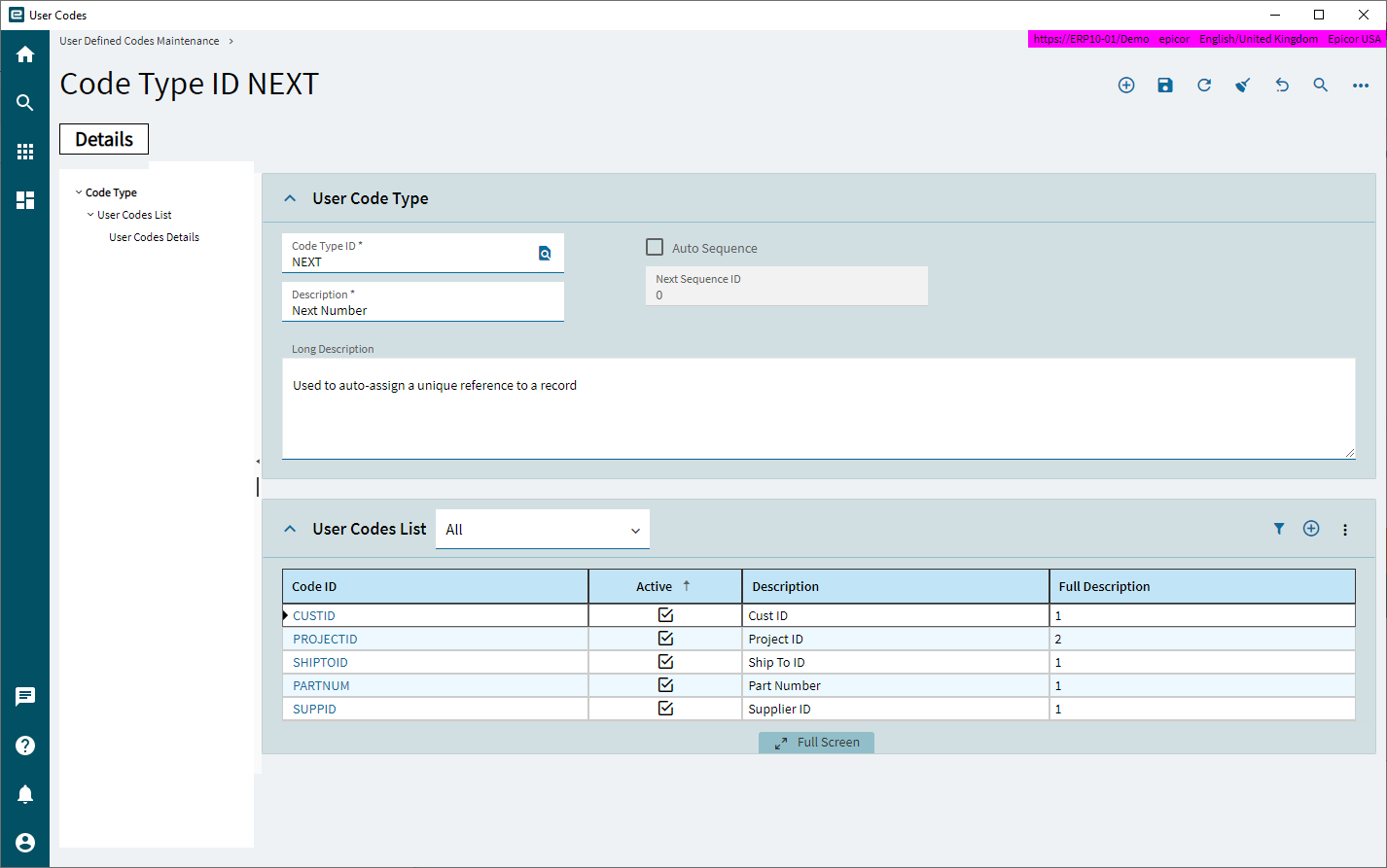

Hi
I create a User Code called “Next” and then within there setup child records for each type of Auto-Assign that i want to do (e.g. Cust, Part, Supp etc.) where the Long Description holds the first number I want to use/assign:
Then I do the Method Directives as you detail, however on the Pre-Processing directive on Customer.Update I just have a Custom Code widget containing the following code:

This grabs the current number in the UD Code, pads it out with leading zeros and appends a pre-fix before going and incrementing the UD Code by 1
