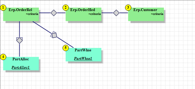

We are attempting to setup the Automate Fulfillment Rules and Process. Our goal is for the system to check all orders as they come in, for include only ship complete, exclude credit holds and if in-stock Inventory is Available (Meaning not allocated to another Order or allocated to a Firm Assembly Job) then it can be allocated and released for picking. We created a BAQ that handles this for the automation process to allocate the correct orders. Here is the tables and joins.
The Automated Fulfillment Rule will retrieve all the orders on this BAQ where we do not filter the BAQ by the calculated_AvailableY_N.

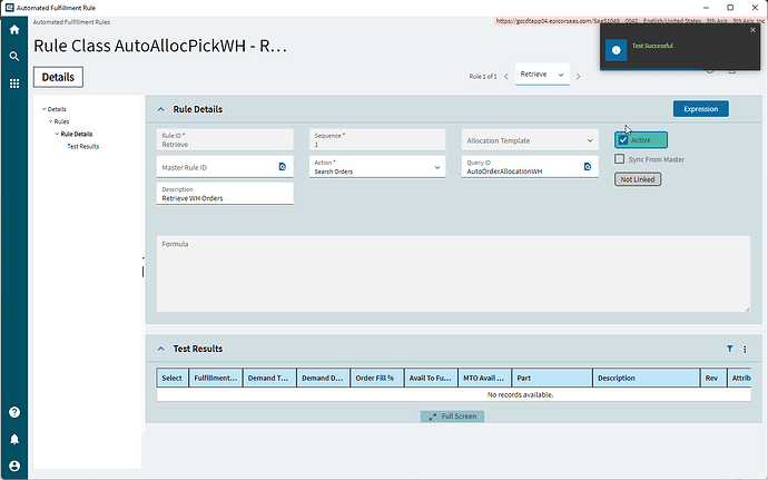

But when we set the SubQuery Criteria Below in this image

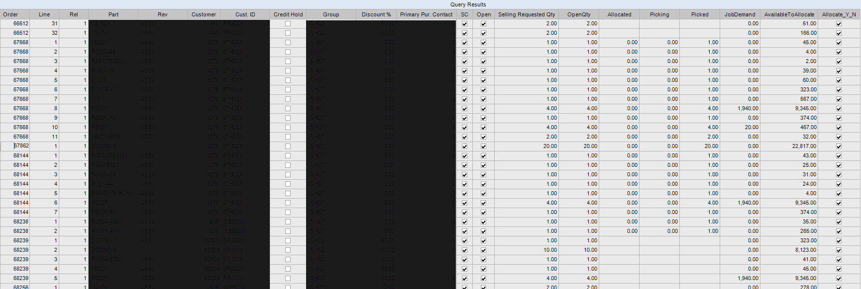

Query Results
The Automated Fulfillment rule will no longer return results from the BAQ.
We get a test successful but no results. If I delete that subquery line, save and run test I get success and it shows all the Order Releases from the BAQ. Does anyone know anything about this?

Hi Keith, No we didnt. I opened up support tickets with Epicor but they were no help. We worked around it by modifying baq so that we didnt use the subqueries anymore and forcing the BAQ to only pull sales orders that the CS Team has marked “Ready To Fulfill”. Sorry for taking so long to get back to you.
Should be addressed though as a bug, subquery filters should work on BAQs used to make fulfillment rules.
I agree 100%. Unfortunately Epicor did nothing to help me resolve it or address it as a bug. We found a work around so I let it go. I wonder if it would work after that last couple updates.
