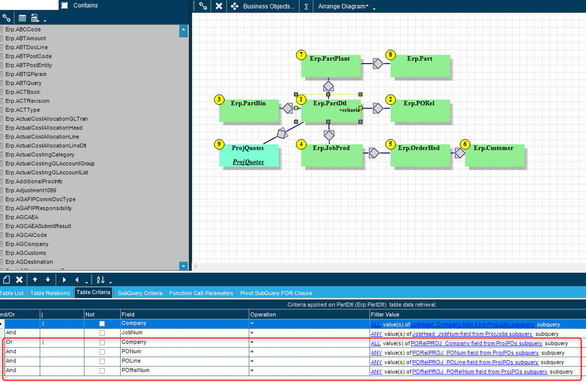

In ProjPOs and ProjJobs add ProjectID as a field.
Add ProjPOs and ProjJobs in the top query joined to partdtl as an outer join all rows from PartDtl
For your Calc_ProjID field set it with a Coalesce which takes the first not null field.
MAX(coalesce(ProjPOs.PORelPROJ_ProjectID, ProjJobs.JobHead_ProjectID,'NA'))

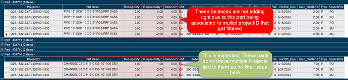

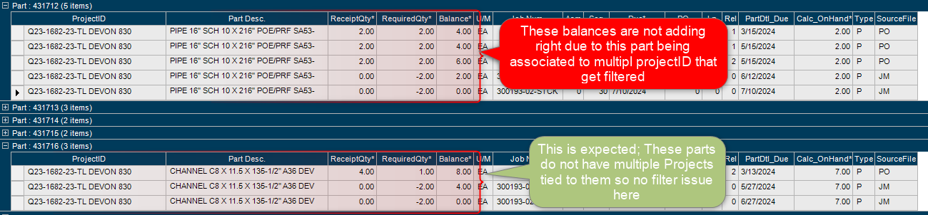

Hi Greg,
I tried your suggestion and it did not return the expected results.
Due to the query pulling one data and making the calculations based on those results it causes the running sum to be wrong on dashboard side due to the filter.

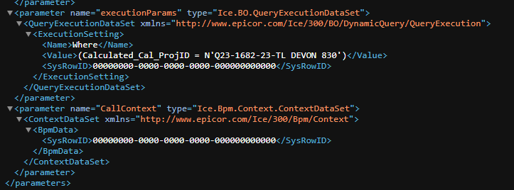

If you had a tracker on the dashboard it should have sent the project to sql with the query and the running sum should only have included results that matched.
If you turn on baq tracing to the server log you can see the actual query that was submitted to sql.
I do have the tracker on the dashboard.

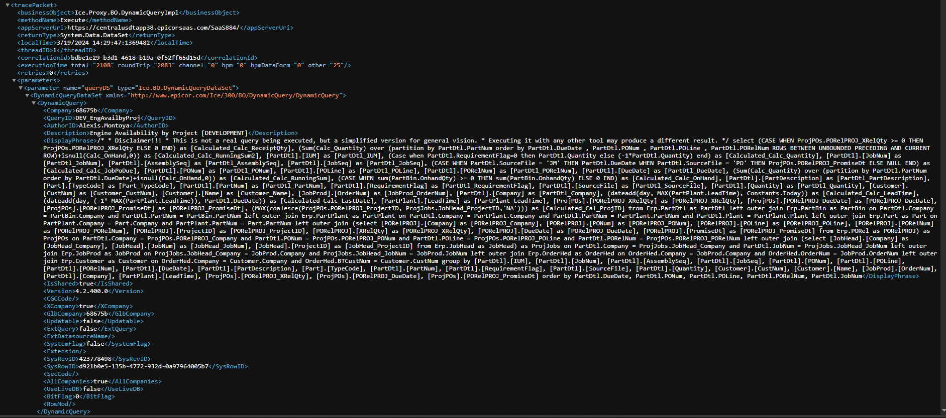

When reviewing the Trace I think I am reading it correctly. Looks like the Query is just the same string from the BAQ:
and the first reference to the projectID i submitted is here:
Attached the trace in case.
EngineAvailability.xml (1.7 MB)

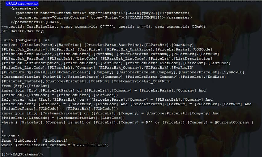

Your are SaaS so I think you now/recently got the server logs.
Here is a query of mine from the ServerLog. It has the partnumber in the where clause that was sent to sql at the bottom.
If that goes with your project to the server I think it would just return your project. If you upload the dashboard I will run it against one one my 23.2 instances to see the baq statement. since I don’t have any project data it is hard to check, but I can at least see the query.
