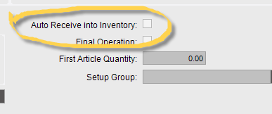

Are you trying to move the WIP inventory between bins (Need AMM module for this) or receive the inventory to stock?
If trying to receive to stock, have you looked at the part method setting Auto receive

when you move the inventory before it has been received to Stk with a MFG-STK transaction, it is still in WIP.
you are basically moving between WIP bins. It doesnt matter if they are nettable or not.
If you want to automate getting the inventory into Stock, having it Auto receive (see earlier post) after the final op will trigger the MFG-STK transaction and if you have the output bin be that Non-Nettable bin, it should do what you want.
If you are just wanting to move WIP between a 2 bins, you can still control that with the output bin on the resource / groups.
