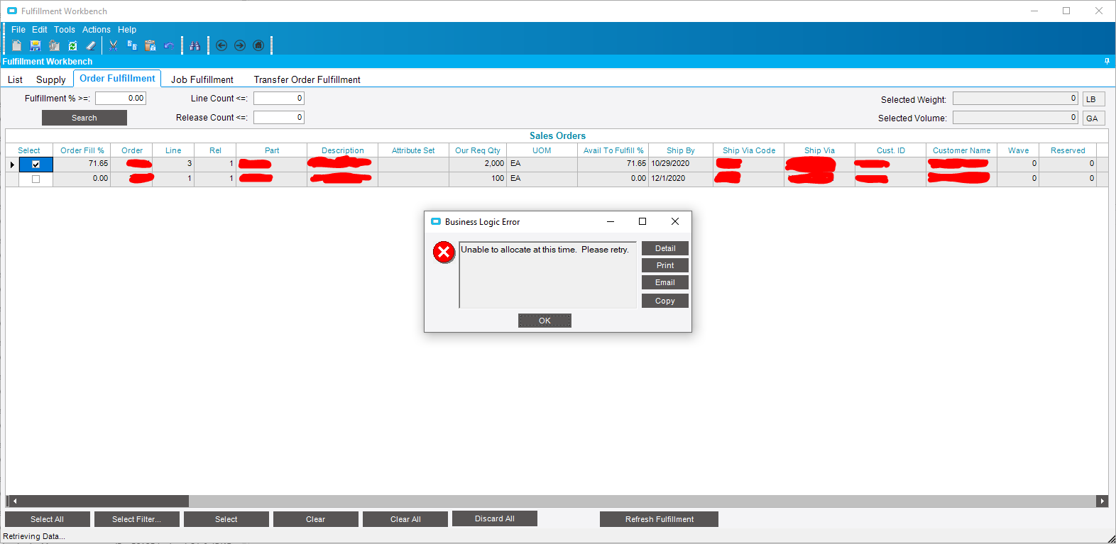

So my Epicor Function works fine (maybe), but I’m getting a weird error when trying to use “Allocate by Lot” in Fulfillment Workbench after having run the Epicor Function. My exact procedure:
  1. Run the Epicor Function described above
  2. Open Fulfillment work bench to verify allocations have changed (they have)
  3. Attempt to allocate more material to the order via Fulfilment Workbench (by Lot).
  4. receive the error below:
My gut says some tables are probably not getting updated (maybe I’m not using GetFWBLimitedRefresh correctly). The Error occurs only for the part (specifically the lot) that I ran the customization on.
I have already tried “Refresh PartBin QOH” and “Refresh Part Quantities and Allocations”. At one point I fixed it but I’m not sure what I did. The error returned once I ran the function again…
Any guidance is greatly appreciated.
Edit: Interesting to note that changing AllocateByLotBin() to AutoAllocation() does not result in the same issue… Must be something specific to AllocateByLotBin() that I am implementing incorrectly
I am going to continue to update this post in case someone is trying to automate Fulfillment Workbench in the future.

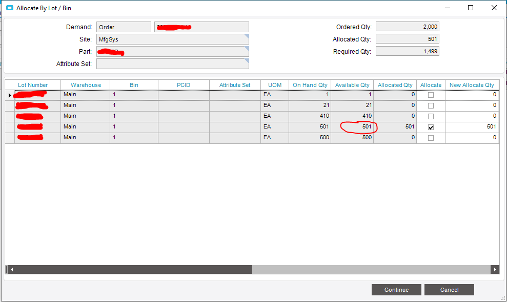

I believe the problem is that the “Available Qty” is not being decremented when I call OrderAlloc.AllocateByLotBin(). You can see in the below screenshot the quantity circled in red should be 0. The exact procedure to arrive at the below screenshot is as follows.
  1. start by clearing all allocations of the given part
  2. Run the Epicor function which is supposed to allocate 501 pieces of lot XXXXX to demand Order YYYY/YYY/Y
  3. Open Fulfillment Workbench in the client to see if allocations have updated properly (below screenshot)
I have not solved this problem yet.
