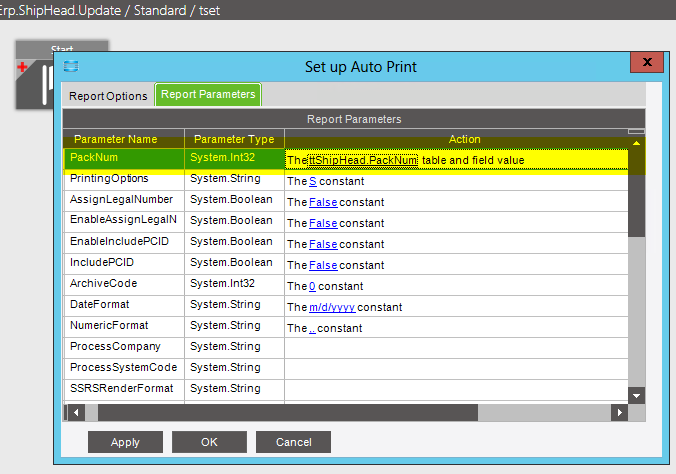

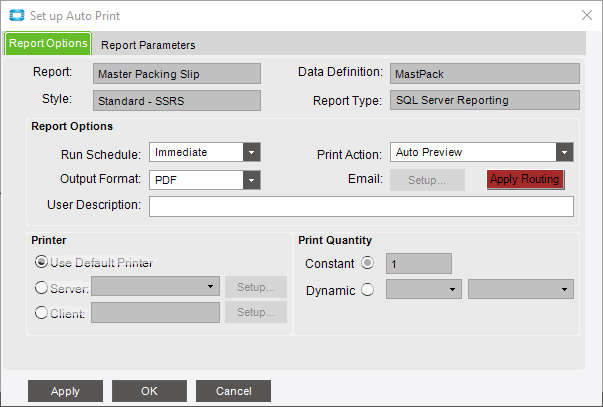

I’ve set up the auto print as below:

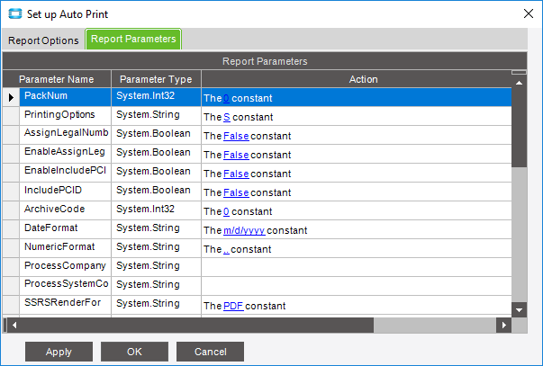

and the parameters as:
I’ve tried numerous values for PackNum including putting the pack slip number in as a constant, but I always get the same error:

Please try this:
In the Set up Auto Print screen for the PackNum parameter, click the drown down and select The specified table and field value.
Click on the word specified and check PackNum, then click OK.
It should look like this. Then click Apply.
Save your changes and try to trigger this autoprint again.

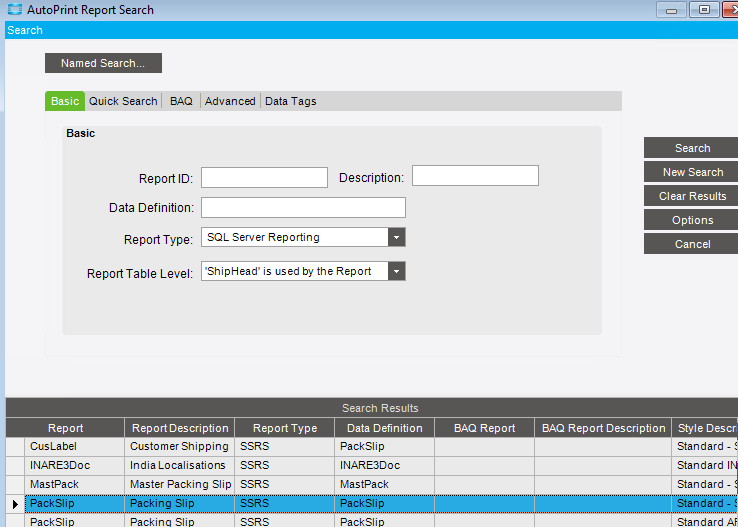

Thought so. Your report selection is wrong as you have Master Pack. Search for Pack Slip this way and use it.
I thought it was a little strange, but the only choices I saw were MastPack and a BAQ report. There’s no PackSlip report listed. I then realized that in your example the table level is “used by” and I had been leaving it at the default “primary” setting.
When I changed that, I got the PackSlip report. I set the PackNum parameter to ttShipHead.PackNum. Still get the same error. Tried setting the PackNum parameter back to the default 0 constant and set the PackNumList parameter to ttShipHead.PackNum.ToString(). Still get the same error.

I have tried this on .500 and .600 just to rule out issues with auto print functionality. This seems to be task agent related on the submission of a task to the agent vs. the agent actually processing the task.Could you try making the schedule queued vs. immediate?
That seems to have fixed it. Thanks for all the help.
