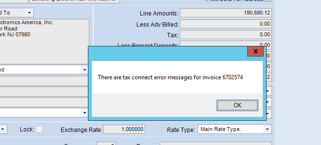

We are having the most fun problem with Avalara and I’m trying to see if anyone here has seen it before. We are trying to create a large invoice 110 Lines with Misc Charges.
Everything appears to work ok, except on “SOME LINES” when we add Misc Charges we get an error back from Avalara
Normally this means bad address or whatnot, however until we put the Misc Charge in (no error)
If we change the address, it works, but this address works fine without Misc Charge… Another address works fine with Misc Charge. If we re-create this Invoice and this Line (only this line) with the same address and Misc Charge it works fine
It is only if its part of a larger invoice that this issue occurs, it isn’t a timeout issue since we can keep adding lines and it will work as long as we dont hit this random line (or any of the other handful of random lines in this invoices)

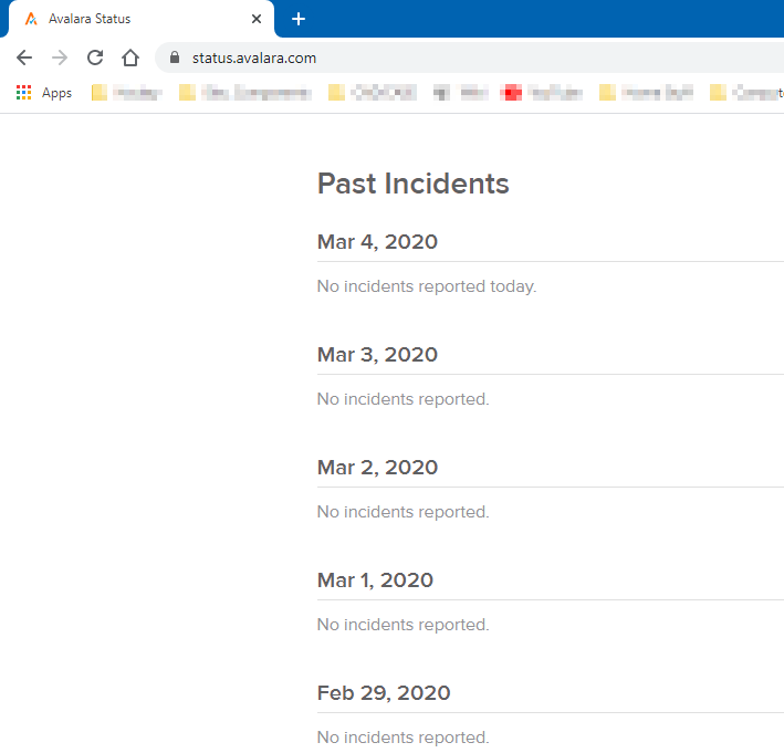

Finally heard back from Avalara, aparently its an issue on their side
Our engineers are aware of the issue you’ve reported. They are working to provide a fix. A fix is scheduled for the 2nd week in March. If the release date changes, I will let you know.
As a recap, you stated you are receiving an error - “Sequence contains no elements”.
