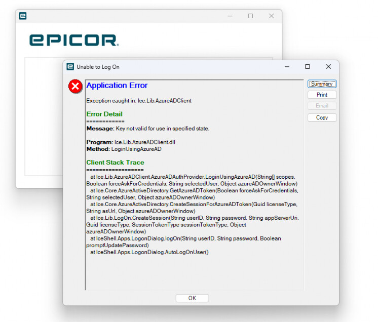

Has anybody ran into this or knows how to solve it? The problem isn’t in any of the setup because browser login works fine. But the client no longer works after the domain migration.

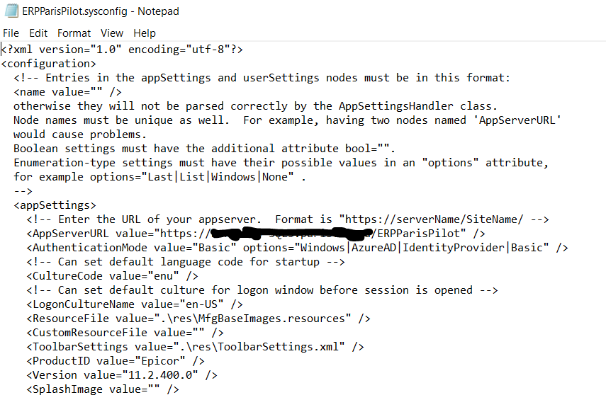

Everything looks right in the config file.

Looks like you have Auto Logon setup.
When you initially configure Auto Logon for the Smart Client, it saves a “Secret” on the local machine that incorporates the Domain, machine name, and Windows User. If any of those are no longer valid, Auto Logon will fail.
You need to have the User manually logon and then reset the Auto Logon option.

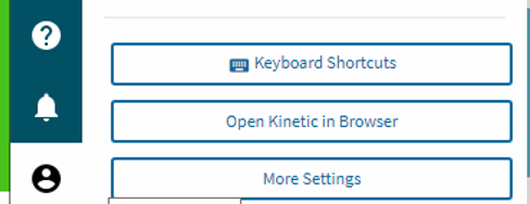

more settings

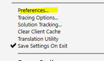

preferences
uncheck and click ok
close open
After it is good then you can recheck auto sign in, close open and it will resave.

But if the user can’t log on, how are they supposed to get to that?
That doesn’t look like the error we are getting and like I said browser logon works fine which means there is nothing wrong in the Azure setup
Good point. In the config is the saved encrypted password and auto login is true.
Set them like this

Just wish somebody could tell us where the “secret” is saved so we can clear it. Its not in C:\Epicor or C:\ProgramData\Epicor
@aosemwengie1 so it is not in the .config file? There is an Azure section there also.
