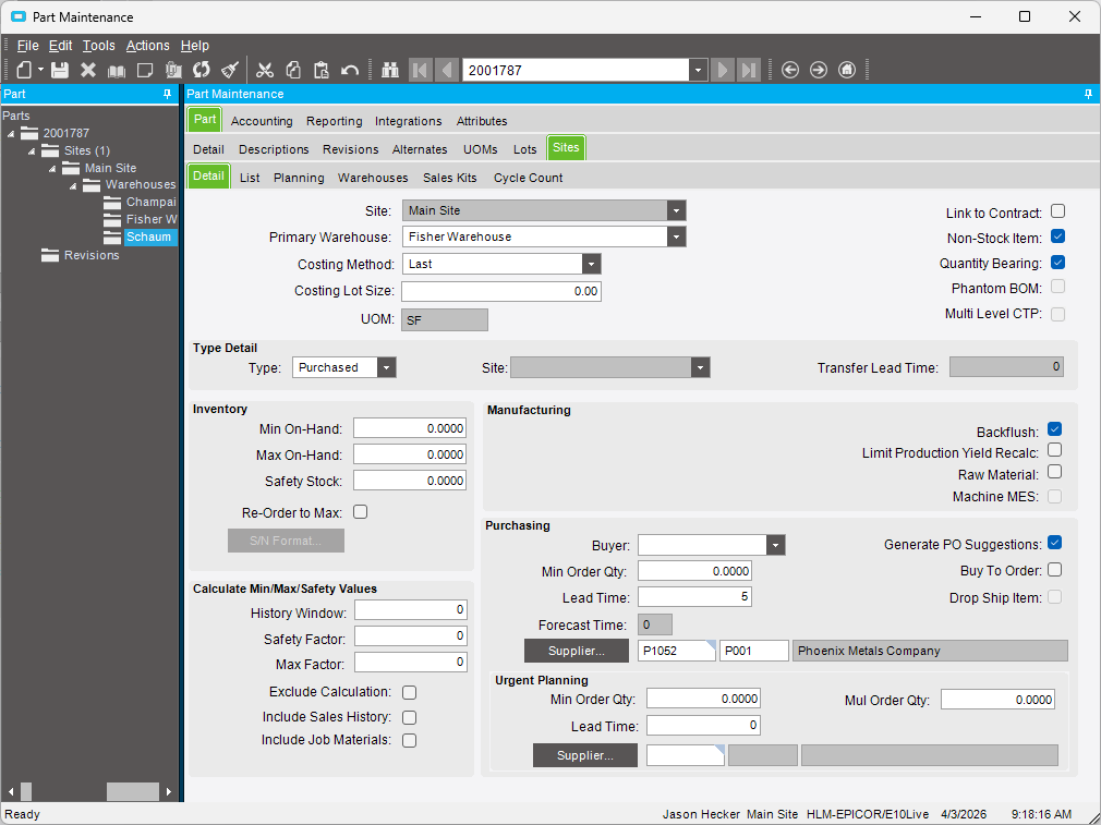

I have a Material linked to an Operation and marked as Backflush.
That Part is set to Backflush in Part Maintenance.
That Operation was marked “Complete” and had a full quantity of 22 pieces recorded against it, but the backflush never took place.
I am wondering why that is. The only thing I can think of is because the Operation took place in a different Warehouse. The Default Warehouse for that Site on that Part is the Fisher Warehouse, but the operation took place in the Schaumburg Warehouse.
The Part is marked as Quantity Bearing on both the Part level and Part > Site level. It is marked as Backflush on the Part > Site level as well.
But, now that I think about it, the Warehouse on the Job Material is set to the Schaumburg Warehouse, so that should preempt any Primary Warehouse set on the Part level…right?
It also appears that this material is successfully being backflushed for this operation (sLASER) on other jobs, but not on all other jobs.
I feel like I am chasing my tail here trying to figure out what is missing here. Anyone have any ideas?

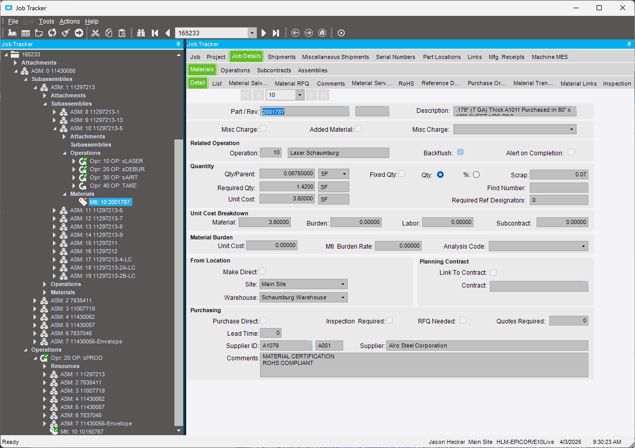

The PART was set to backflush, but is the MtlPart on the job marked backflush? It should default based on the part record, but someone could have unchecked that box on the job.
How? Via MES, Time Entry, etc.? Can you look at that LaborDtl for that entry and see if there’s anything different vs a job which DID backflush correctly?

Yes, it is marked as Backflush on the job as well.
MES is used for 99% of everything, unless we are going in to fix an invalid entry. Looking at the labor entries, nothing looks different or abnormal.
Is it the site record? It is marked as Non-Stock which should generate a job or in this case Purchase direct material.

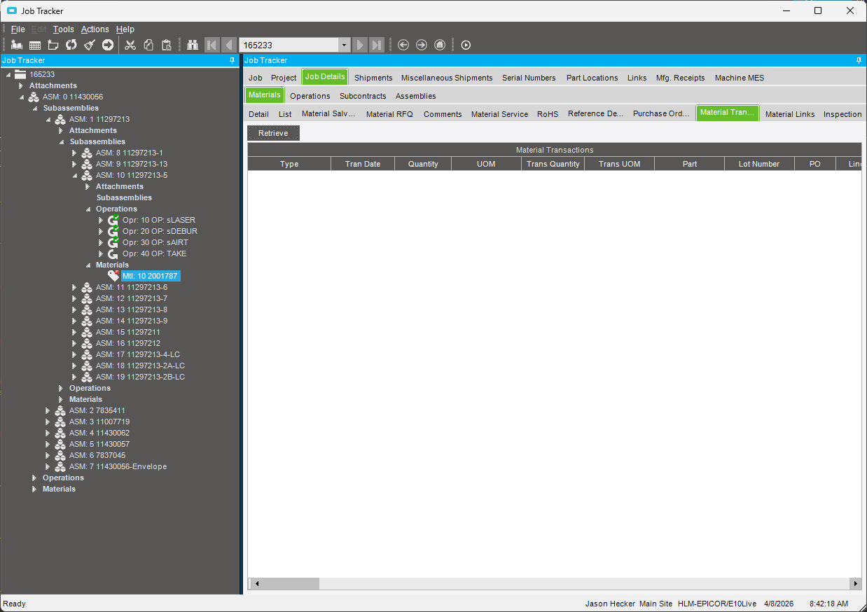

What does Job Tracker > Job Details > Materials > Material Transactions show? Are there any transactions listed for the materials that won’t backflush? Do the quantities make sense?

It is empty, which is what I am finding weird. It should show something, shouldn’t it? I mean if we completed the operation then Backflush should have kicked in and issued those materials (I’d think).

Can you show the material transaction tab in job tracker for that material? It could be a rounding error too where it mostly got issued but not 100% of it.

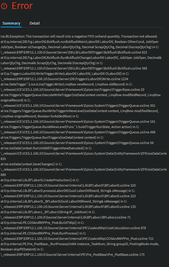

I have a case open because at some point last year we were no longer able to ship packs if a back flush operation on any of the jobs would result in negative inventory. No transactions are even generated if there is enough material when closing the job, so idk why it cares.
They claim nothing has changed, its always been this way and should be this way.
We don’t see why it happens before the jobs are actually closed, and we find it annoying as we would like the job of shipping and the job of fixing inventory or job boms to be desynchronized.
So anyway, in some cases based on the error message, black flushing is prevented by negative FIFO - maybe its not for other costing types.
We do not use FIFO costing here so maybe that explains it. That is scary though.
Its super annoying - the product is already made so preventing it from shipping is insane. Yes it should warn you that inventory is off, but if the product is made let us ship darn it.

Yes, and I think we want it to prevent transactions. But when I shipped a back flush job in the pilot and then checked the material in part transaction history it didn’t make a transaction - the transactions seem to be made when we go through end close jobs.
So to us, its warning us when it should not as its just prophesying that jobs on the shipment will have issues when they close. Maybe its assuming when a job is shipped its automatically closed - but that doesn’t seem to happen for us..

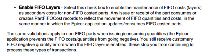

I was doing some digging to try and find some official word on how this works and it looks like FIFO might be an exception to the rule?
I wonder, are the FIFO layers effected before the job is closed? :thinking:

Here is the Material Transactions tab…it is showing nothing after hitting Retrieve.
If I do a SQL Query of:
SELECT * FROM Erp.PartTran WHERE PartNum = '2001787' AND JobNum = '165233'
and it returns 0 rows. So there was no transaction of any kind for it.
