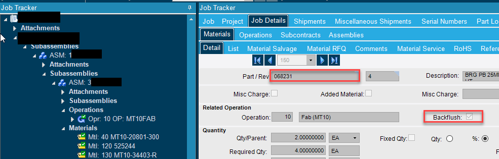

Yes they are. They are marking the operation complete and reporting a labor quantity. See attached example. The part I circled is showing like there isnt any material in the backflush location, but there are 351 pcs in the main stocking location. Note: The parts that are issued are parts that are in a separate warehouse that get hand picked, so they are manually issued and not marked backflush.
Is the material set to backflush on the job? If you just changed the parts, and jobs created before that change won’t be backflushed. You have to check the box on the material in the job.

The jobs were created after the change and parts are marked backflush on the job. We do allow negatives.

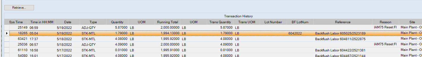

In the image below from PTHT the reference is the LaborHedSeq and LaborDtlSeq that triggered the backflush.
@gpayne , it did that because the labor was a backflush labor transaction. If you aren’t backflushing labor, I’m 90% sure that you do not need that process.
