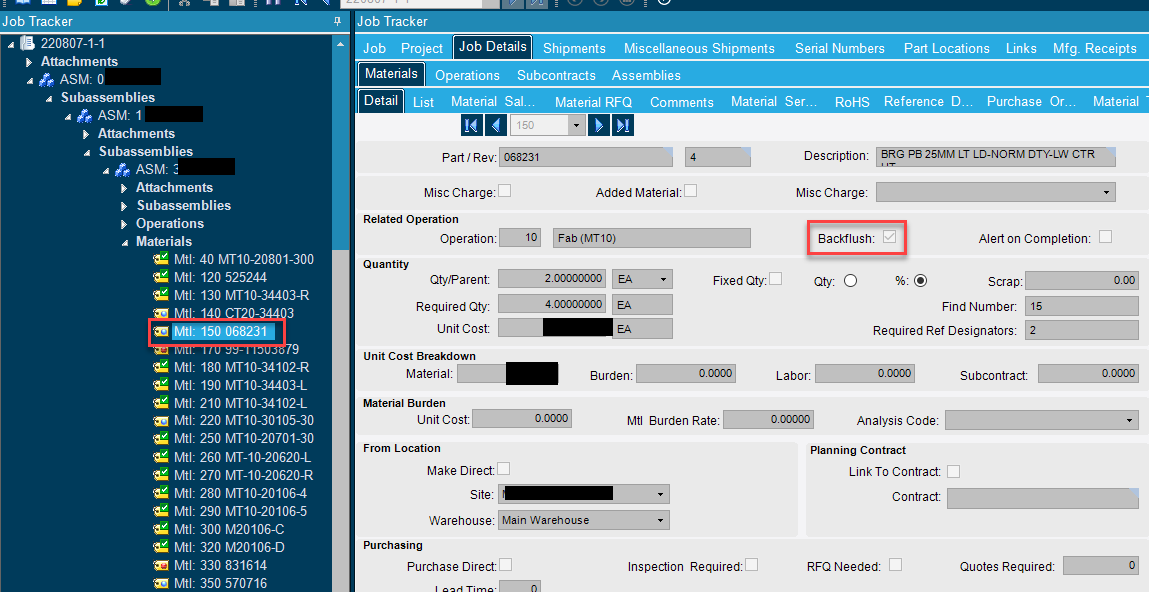

@SPhillips can you post a screenshot of the Job Job Detail Material tab?
Sure. Here you are.
That looks perfect, provided that ‘Main warehouse’ is a valid Warehouse assigned to the part (which I don’t see how it couldn’t be).
and your Opr 10 is the Labor Type either ‘Time & Qty’ or ‘Qty Only’?

Its set for Time & Quantity.
Main WH is the valid warehouse and its on the part.

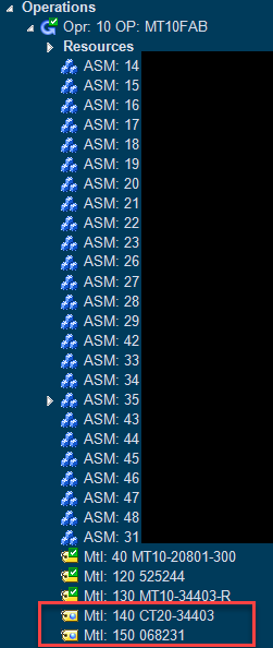

Can you do this screenshot again but with the operation that has materials 140 & 150 attached to it

Sure. Here you go.
Just need a bit more detail. Can you expand that 10 OP: MT10FAB. You should see something like this:
Sorry for the long image. We have a lot of sub-assemblies:
